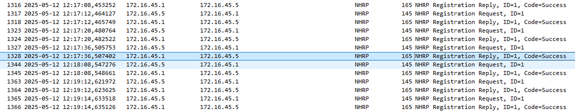

Perhaps this behavior is due to the fact that they are not being NHRP registering.
In Cisco IR1101 (192.168.23.1) NHRP registrations successfull:
172.16.45.1 - wan ip Hub Cisco IR1101
172.16.45.5 - wan ip Spoke Teltonika
But in log on RUT955 (192.168.23.2) I can see like this:

tcpdump on wan int RUT955:
14:24:05.746898 IP 172.16.45.5 > 172.16.45.1: GREv0, key=0x4d2, length 111: gre-proto-0x2001
14:24:05.751043 IP 172.16.45.1 > 172.16.45.5: GREv0, key=0x4d2, length 131: gre-proto-0x2001
14:24:07.758306 IP 172.16.45.5 > 172.16.45.1: GREv0, key=0x4d2, length 111: gre-proto-0x2001
14:24:07.762317 IP 172.16.45.1 > 172.16.45.5: GREv0, key=0x4d2, length 131: gre-proto-0x2001
14:24:11.770805 IP 172.16.45.5 > 172.16.45.1: GREv0, key=0x4d2, length 111: gre-proto-0x2001
14:24:11.773071 IP 172.16.45.1 > 172.16.45.5: GREv0, key=0x4d2, length 131: gre-proto-0x2001
it seems that Teltonika does not accept registration reply from hub:

Is there any way I can diagnose the NHRP problem on RUT955?

Yes, that`s our case. The helpdesk helped us solve our problem!
Everything worked after enabling multicast in the NHRP settings.
