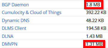

Indeed, you’re correct. The issue primarily stems from limited flash space, with only 2.38MB of free space after the update.
2024-03-06-15-32-59-RUT955 - Teltonika Networks — Mozilla Firefox
Both packages you intend to install exceed this capacity.
2024-03-06-15-33-23-RUT955 Package Downloads - Teltonika Networks Wiki — Mozilla Firefox
Upgrading to an SD card would be a viable solution.
