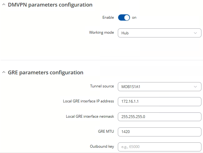

hubs config

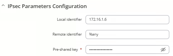

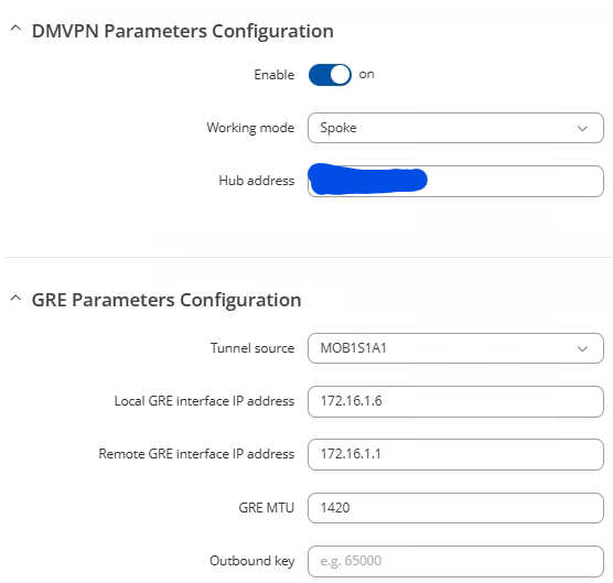

SPOKES CONFIG:

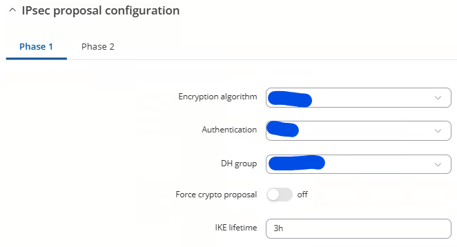

You haven’t set the IKE Lifetime and Lifetime. Try with 3h and 1h and check if the tunnel becomes stable.
Ok, I thought the duration was set by default, but you are right in the manual.
https://wiki.teltonika-networks.com/view/RUT241_VPN
I’ll try it right now and let you know how it goes.

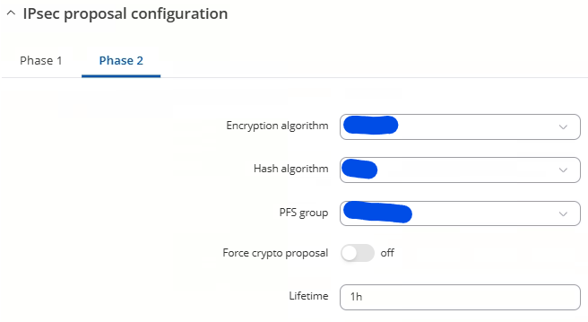

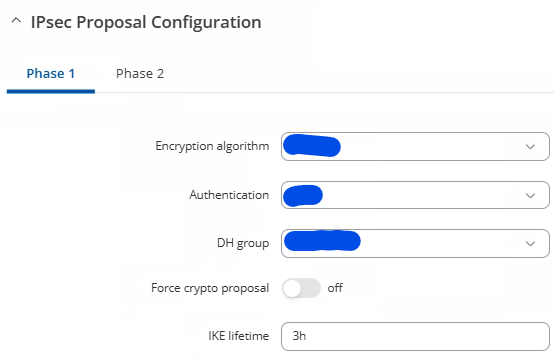

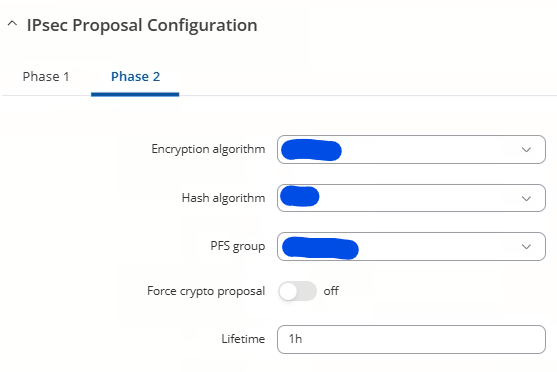

just tested on 3 different devices:
161, 167 and 170
phase 1 3h and
phase 2 1h
but the devices still wont be stable.
config on HUBs:
config on SPOKEs:

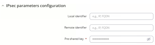

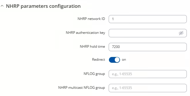

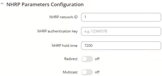

In case someone is having trouble doing a DMVPN with mobile connections this is the configuration that work in my case.
HUB CONFIG:
IPSEC
NHRP
SPOKE CONFIG:
IPSEC
and using BGP for the routing between sites.
