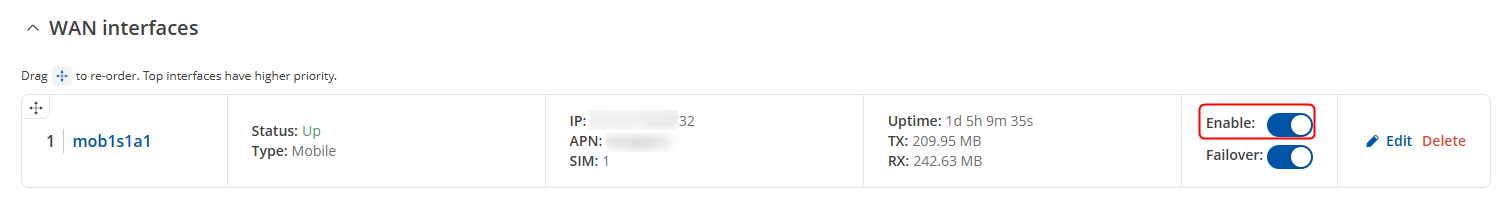

  • I’m aware it’s possible to disable the mobile data connection of the routers but I can’t find a way to fully disable the mobile connection so that it doesn’t dial up a mobile connection at all. Is that possible and if so, how?

The most straightforward way would be to simply take out the SIM card from the device; no mobile connection will be established that way, but of course, I don’t believe that’s what you would want to do. Another option would be disabling the mobile interface under Network → WAN → and disabling “mob1s1a1” and “mob1s2a2” interfaces:
