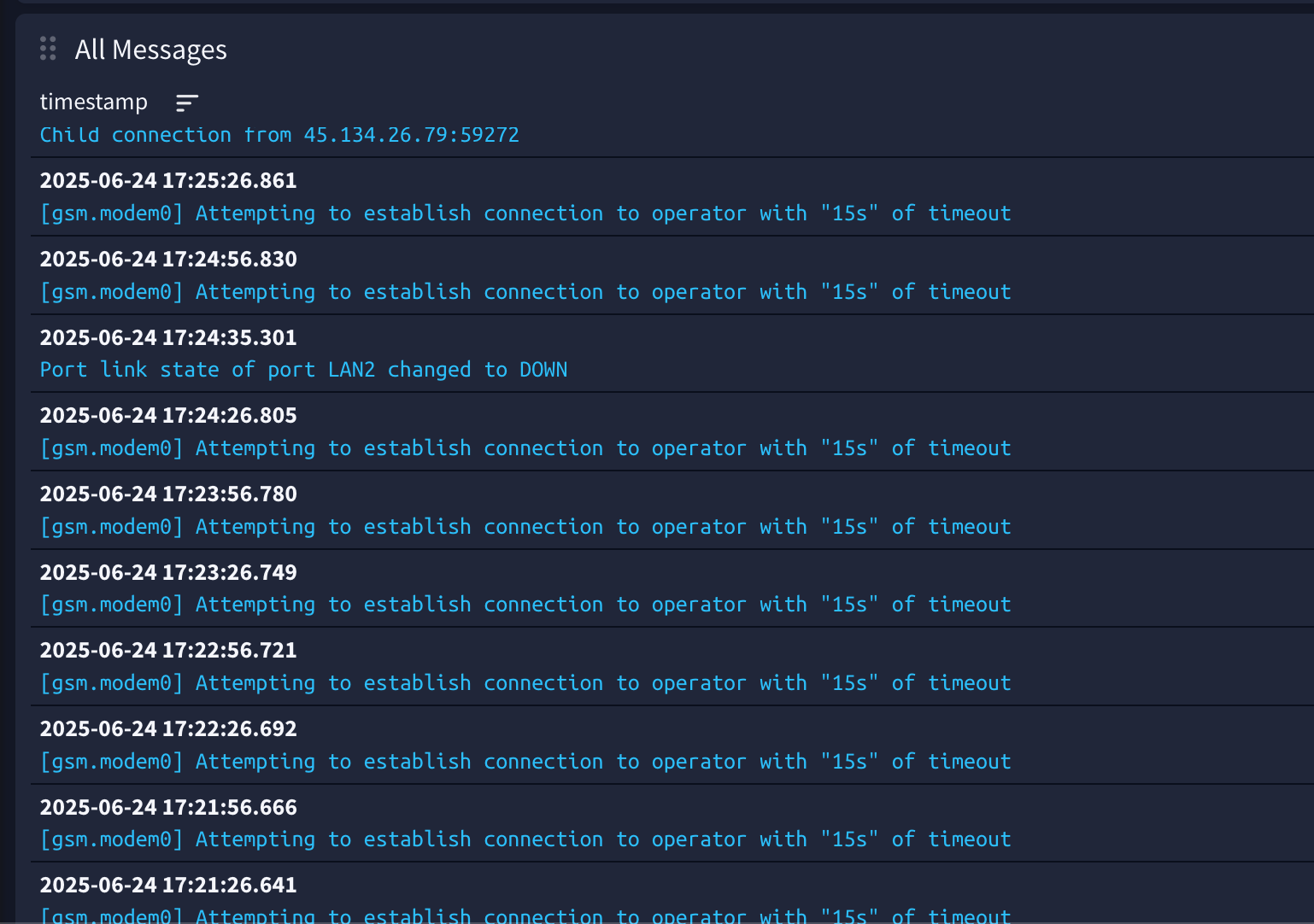

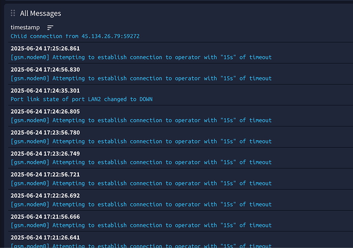

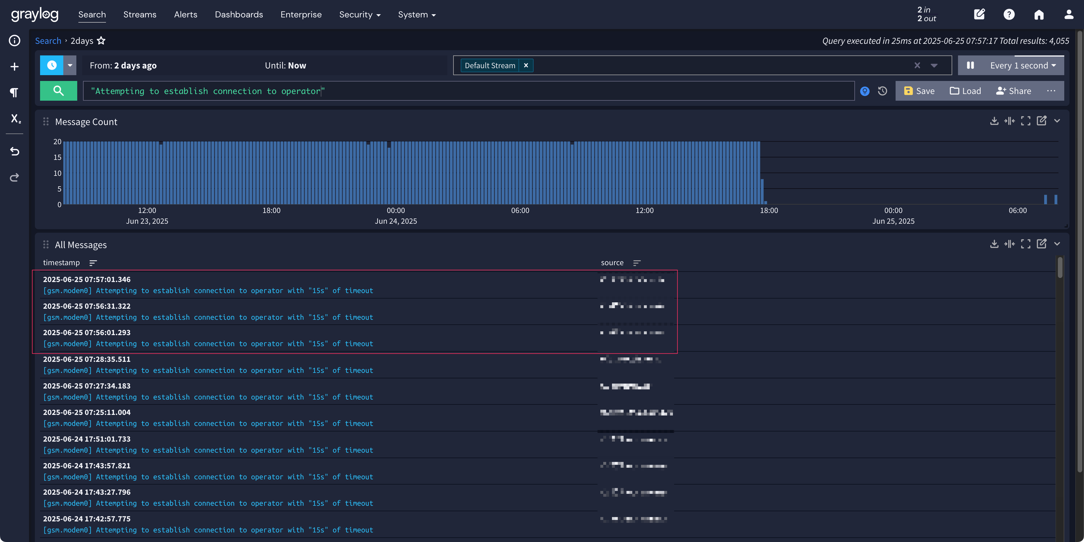

Is there a way, via config file edit, GUI, or other … ? to “permanently” disable the internal LTE modem of a RUTX11 ? I have a few sites where they no longer wished to have the LTE service charges so they have suspended the accounts. But, the modem dutifully tries to connect, causing a constant stream of log messages to my SIEM server (every 30 seconds):

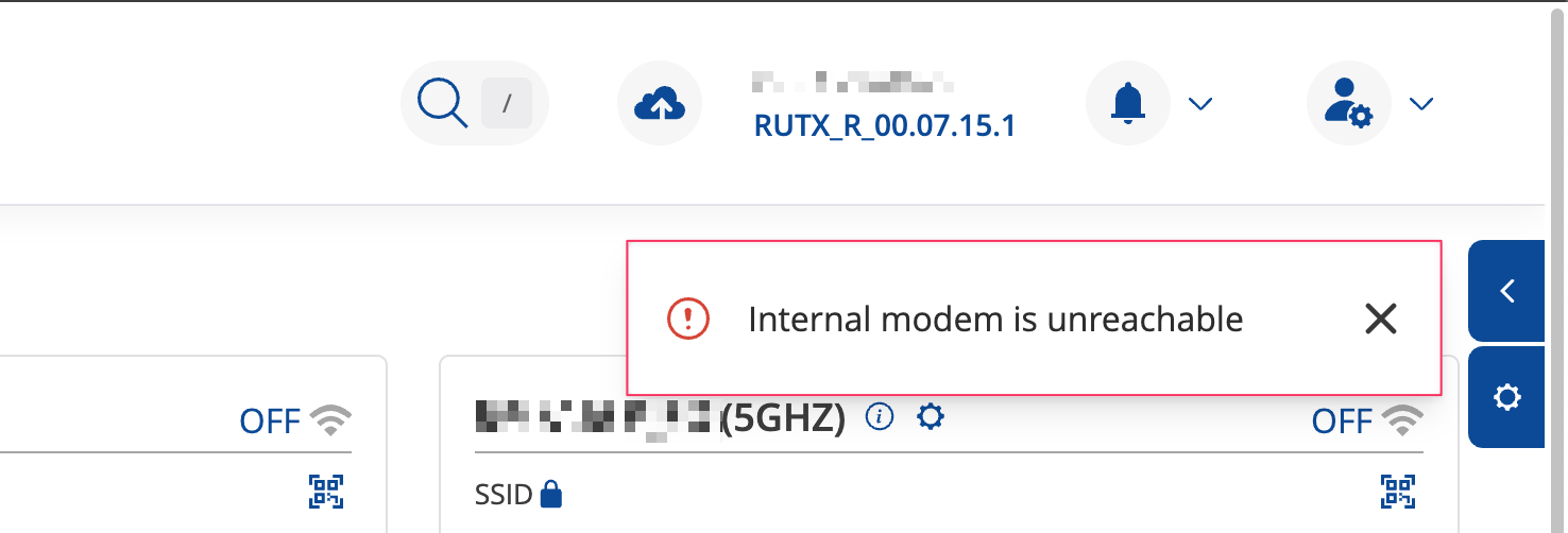

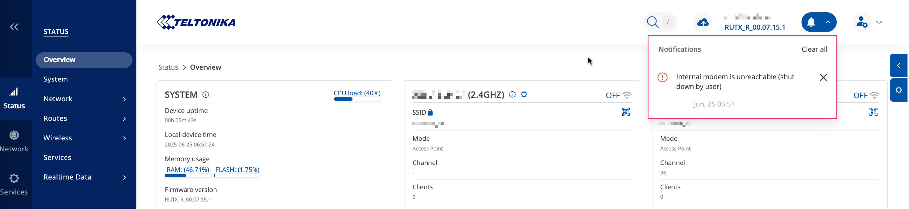

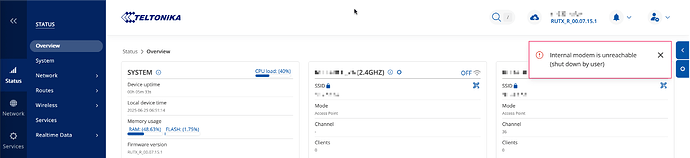

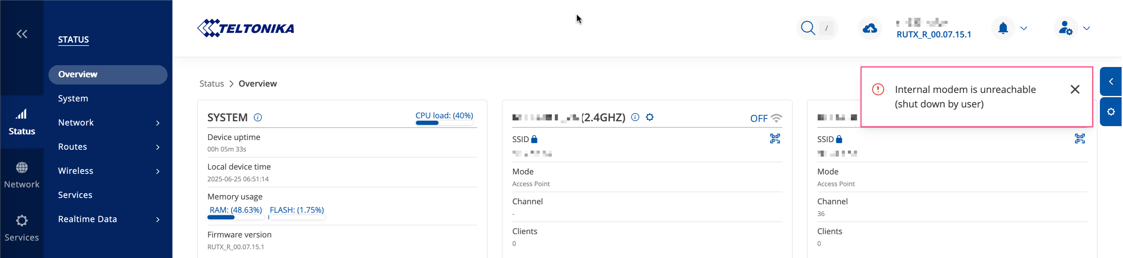

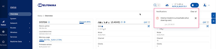

Alright, but this has an ugly side effect: when logging in to the WebUI, it flags this as an error condition (displays every time the “Overview” page is loaded actually):
I was looking for any options to disable these notifications, but unfortunately, couldn’t find any.

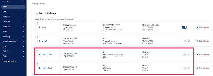

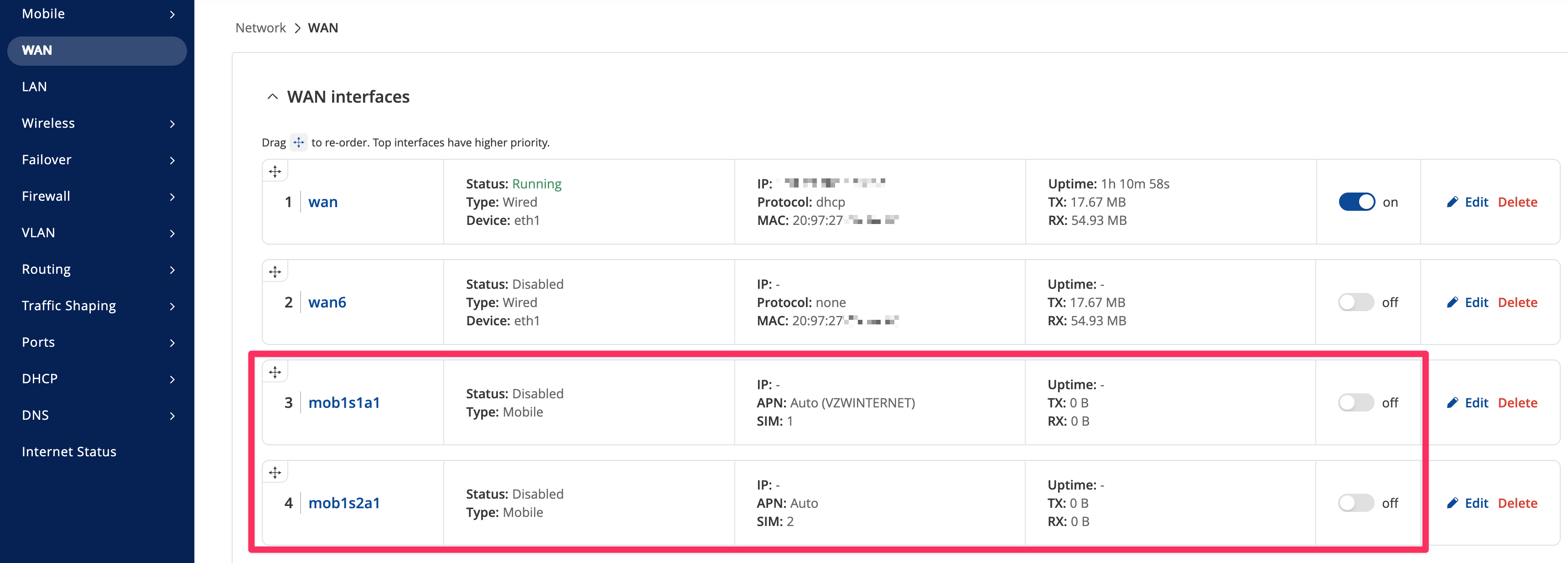

What if you were to disable instead the mobile interface under Network → WAN? I’ve tried this and took a look at the logs, and it looks like no error messages or any connection attempts are being made, weird how I didn’t think of this with my initial reply.
Thank you for trying, but unfortunately that doesn’t work… I already had both mob1XXXX interfaces switched off in the UI:
As soon as I powered the modem back up, the connection attempts started appearing in the logs again…

After running those commands, the warning messages start to appear again…
Unfortunately, that’s just how it’s going to be then. I don’t believe there’s a way to disable the modem messages, as the router is partially designed to be used with a mobile connection active.
