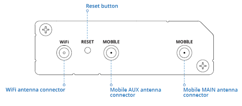

The RUT241 has two mobile antenna ports. I understand that the one farthest from the wifi antenna port is the main, and the one closest to the wifi antenna is the aux.
Is it ok to get one of those yagi directional antennas and connect it to the the main mobile port, and then leave the included mobile antenna connected to the aux mobile port? The yagi would be run outside the building and pointed towards the nearest tower.
Is another option to purchase two yagi antennas and run them both outside, but install them at different orientations… one mounted the “normal” way and one mounted on its side… but both pointed at the tower?
I have some of the telktonika PR1KCL25 antennas and they have two cables… one for each mobile antenna port, but I haven’t seen any yagi antennas with two cables… is that also an option? Anyone know where to get such an antenna? In a scenario with a weak signal coming from a single tower, would I be better off using a single yagi vs. using the PR1KCL25 mounted outside?
