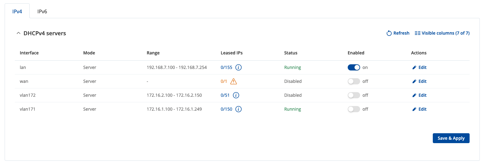

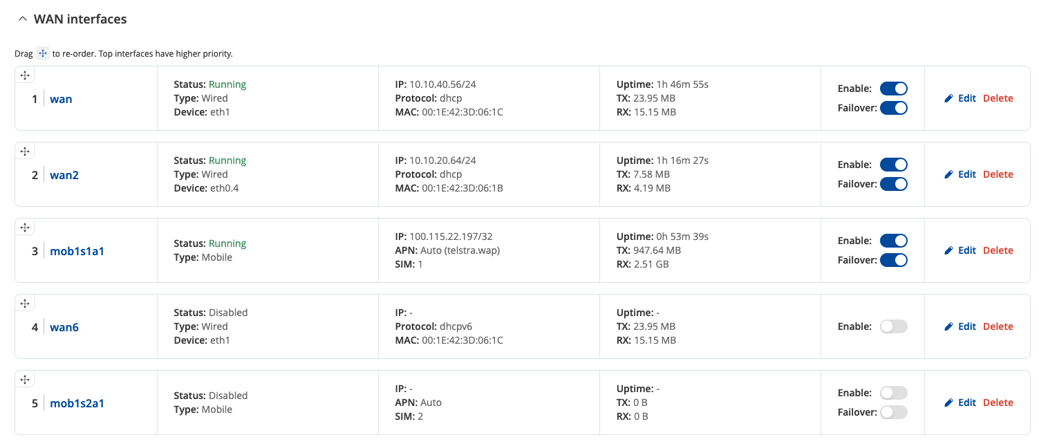

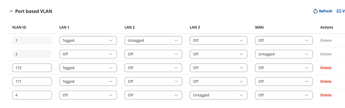

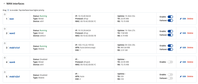

I’ve not been able to work this out, it seemed to be working fine when I had one WAN port configured, then it appears to have all stopped working when I introduced another WAN2 port using LAN3 port.
DHCP stopped working for all interfaces and packet loss rose.

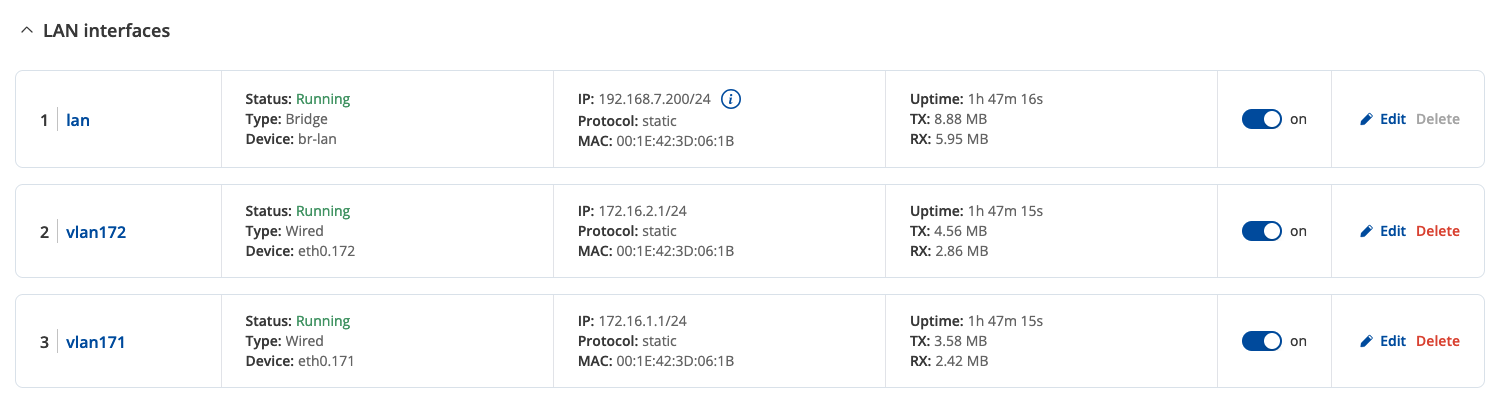

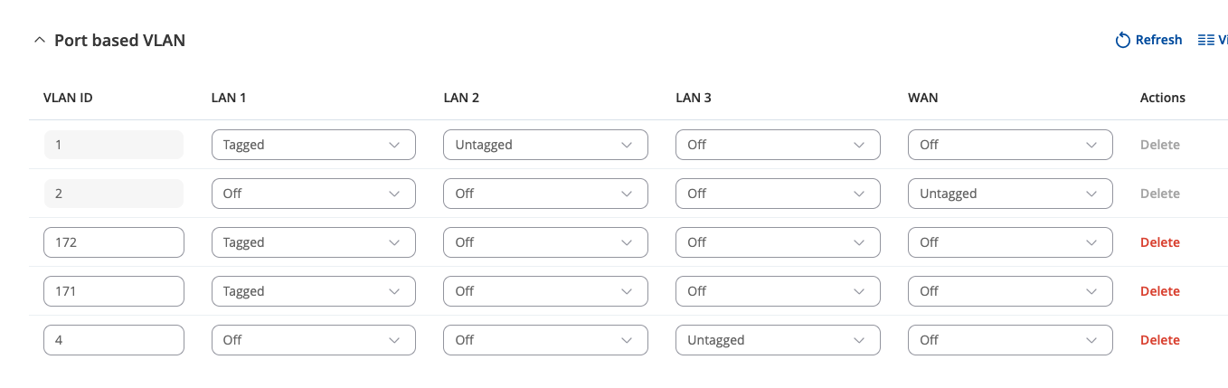

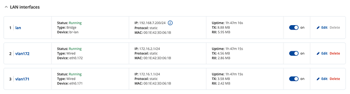

I have one LAN port configured as a tagged interface, with two new vlans interfaces, eth0.171, eth0.171

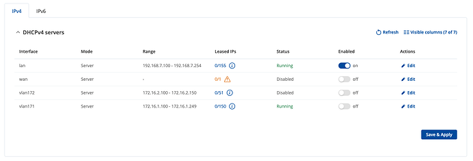

It seems that I can’t use DHCP Server on any interface now. Do I need to remove the LAN3 port from br-lan ? Or have my policy based routing rules introduced a new issue.
packet trace shows requests, and invalid packets, I suspect this is because the eth interface is recieving a tagge packet and cannot parse it.
The odd thing is that if I connect a standalone PC directly to another port on br-lan, DHCP no longer works as well.
I see no DHCP replies when I run a packet trace on the RUTX11.

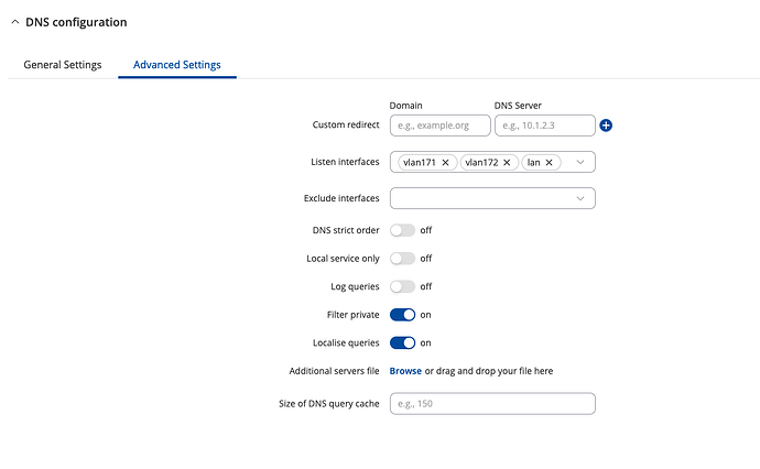

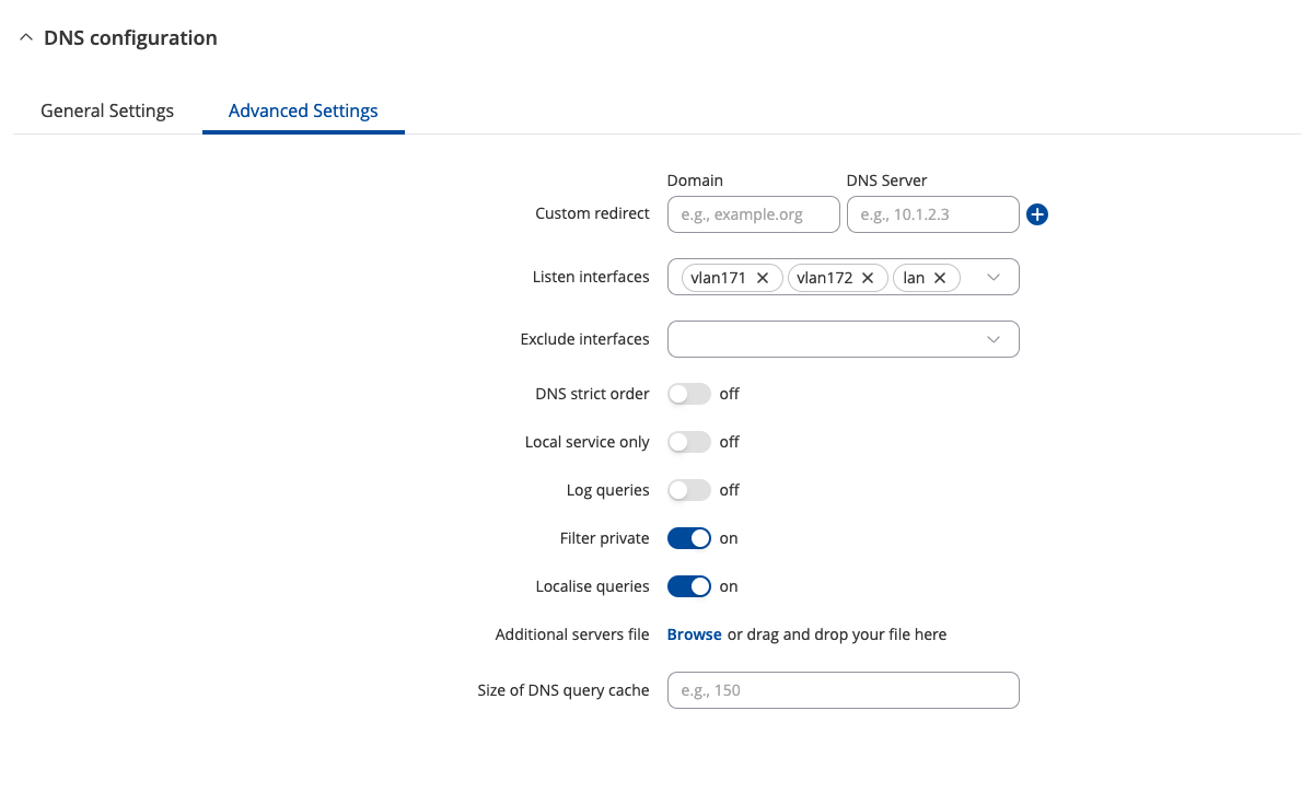

Ok I think I solved this one. I had to setup each interface on the private network side to be under the Listen interfaces. Once this was done, each interface gateway responded to the DHCP request with a reply fronm it’s own network.
Hope this assist someone else if they come across the same issues.
