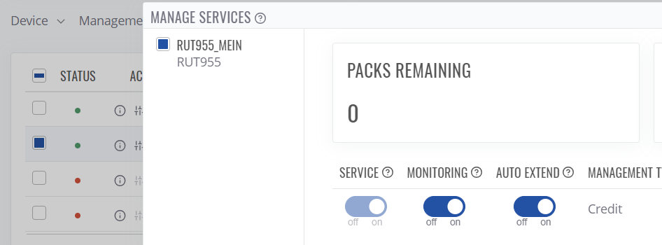

Please, ensure that you enabled monitoring for the device in the RMS settings. Select your device in RMS, click on the ‘device tab’ and then on ‘manage services’. There, enable monitoring for the device.
