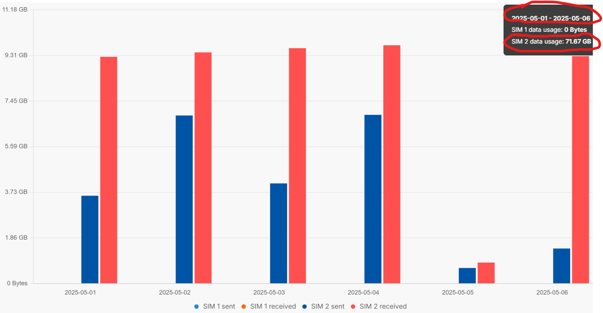

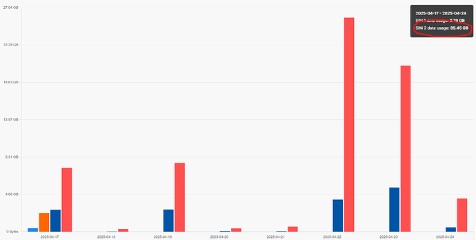

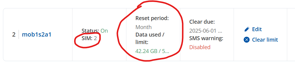

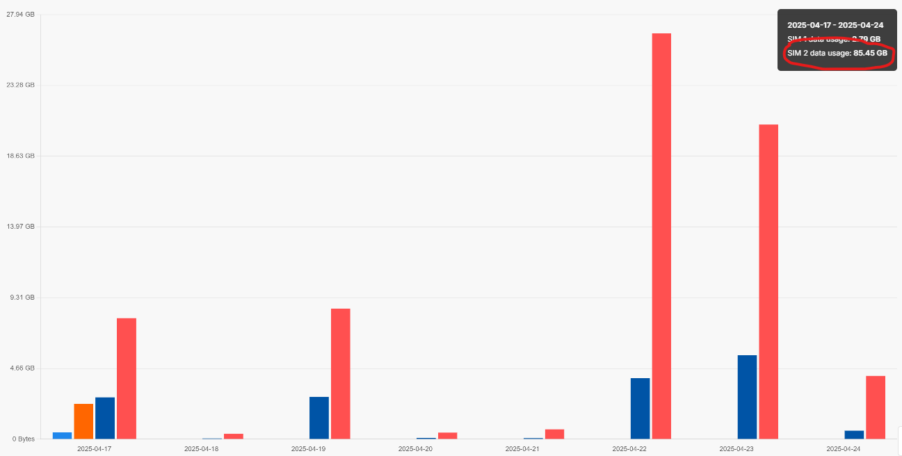

I set sim data limits on RUTX50’s when configured, and i have noticed the Data usage shown on the local router doesn’t match up with RMS data usage value. you can see in the second image when sim 2 started using data this month. We need a better understanding of which data is correct and why they different values

Apologies for the delay. I assume that the data limit on SIM 2 was configured after the actual data usage had already started being recorded on RMS, meaning that approximately 9 GB of usage wasn’t captured locally on the router’s counter. In this case, the value displayed on the RMS page would be the correct one, as it has been tracking data usage continuously from the start.
When the data limit resets (or if it already has), the local router and RMS data usage values should gradually align again.

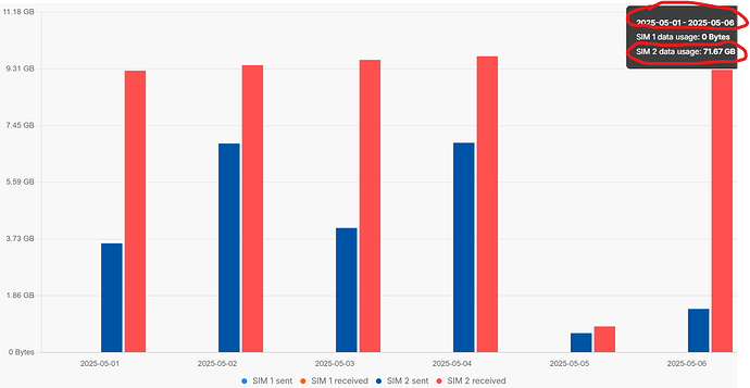

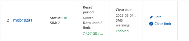

thank you for replying.
i have provided more screen shots to show the data usage information is not aligning. the data usage limit on the router reset on the 1st of may 2025.
May 1st to may 6th the data doesn’t look like they are gradually aligning.
