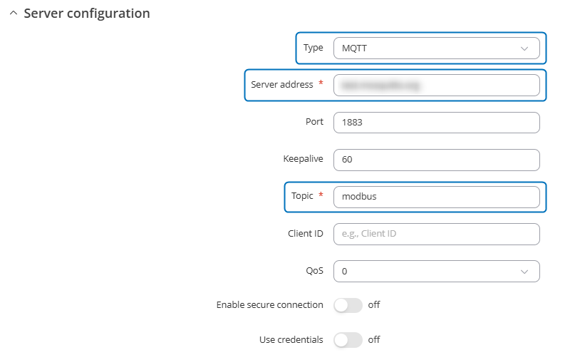

If it’s about Modbus client alarms, then yes, these can be sent to your local or cloud server using the Data to Server service via the MQTT protocol. In this case, in Data to Server setup, you would:
  • Set the Type to Modbus alarms.
  • In the Server configuration section, specify your MQTT broker’s address, topic, and credentials (if required).
Data to Server setup example
