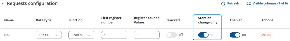

However, there is a helpful alternative you might consider: in the Modbus Client Request settings, you can enable the Store data on change only option:
With this enabled, the device will only store and subsequently push data via the Data to Server when a Modbus value actually changes. If the data remains constant during the offline period, it won’t get queued or sent when the connection comes back.
