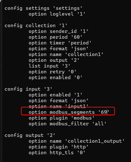

  4. Go to the line of option modbus_segments '64'
  5. Change the number to the one you want:
  6. Press ESC (escape) on your keyboard to stop editing
  7. Write :wq to save the changes and exit out of the editor
  8. Afterwards, I suggest restarting the Data to server service by writing /etc/init.d/data_sender restart
  9. Changes will probably not be visible within the WebUI, but they should be changed (as we did them within the config).
Simply test right after and if it works, it works.
