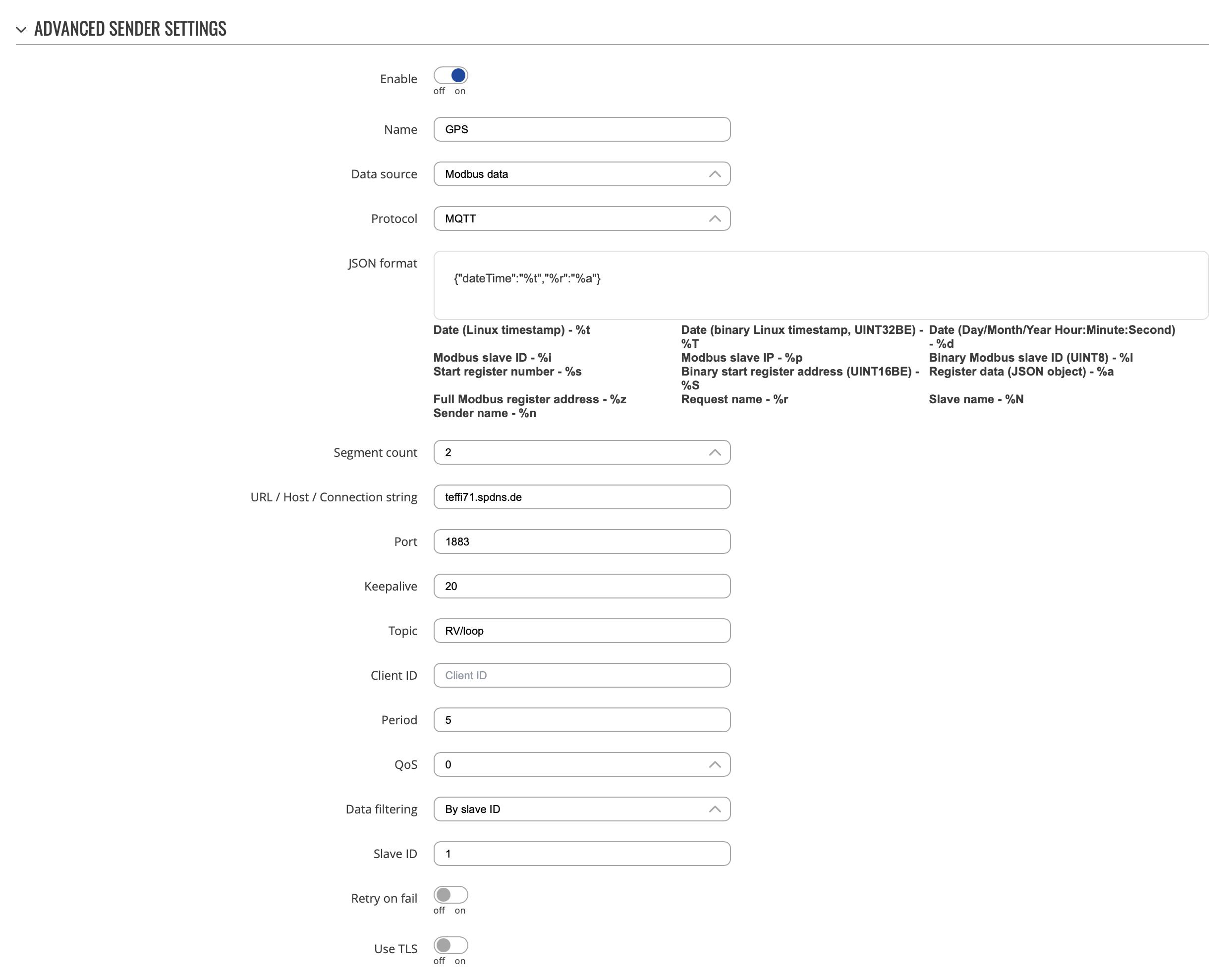

My current JSON string is:
{“dateTime”:“%t.0”,“%r”:“%a”}

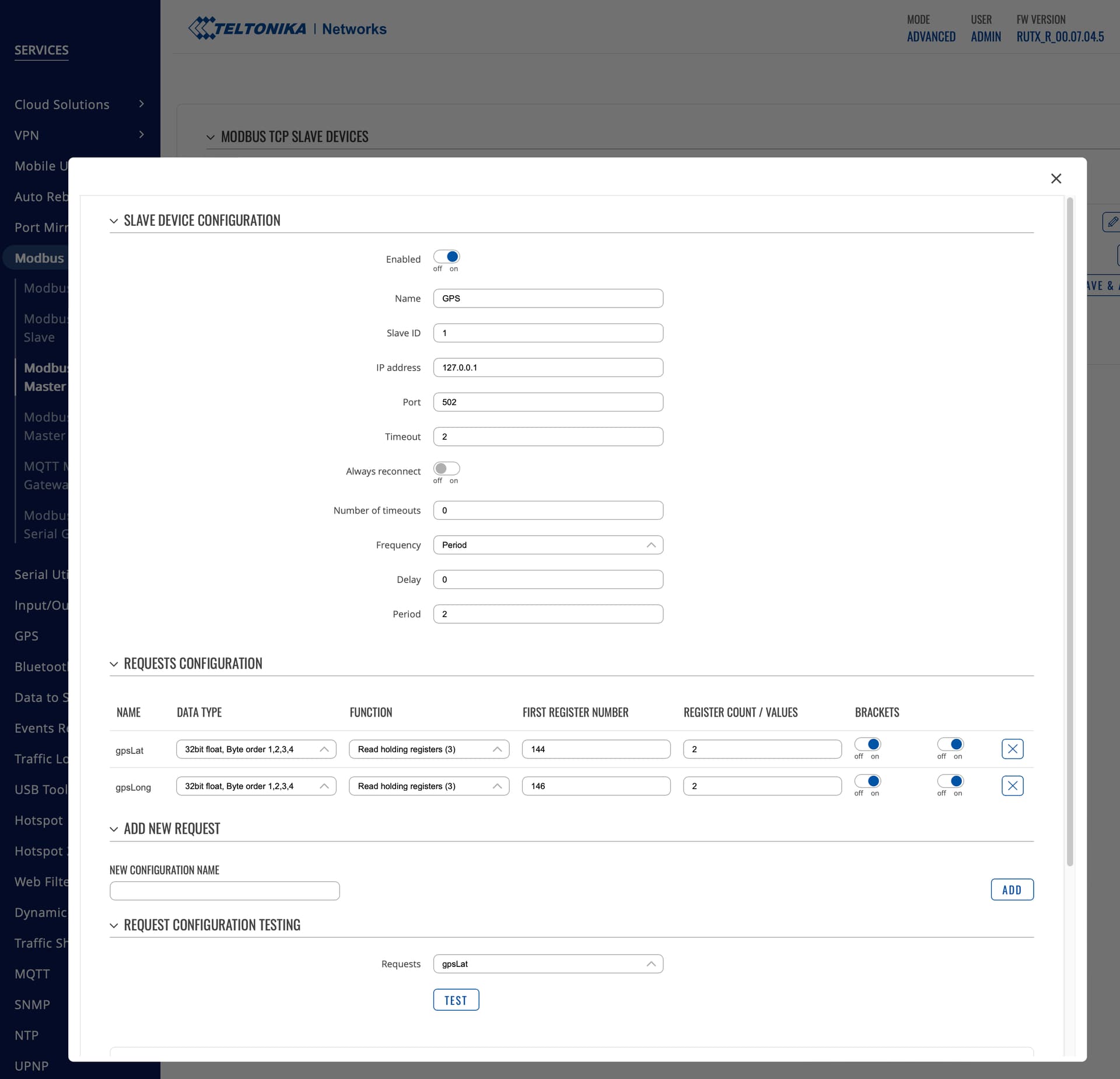

How can I specify a specific First Register e.g. 144 for latitude and 146 for longitude in the JSON string?

It should be enough to change the Segment count option to All instead of 1. Make sure that both registers are being read from the same Modbus Master instance (so that they both arrive together).
The JSON format string should look like so:
{“dateTime”:“%t”,“%r”:“%a”}

Segment count was actually on 2. If I change it to All, I get this:
[{“dateTime”:“1693220784”,“gpsLat”:“52.152493”},{“dateTime”:“1693220784”,“gpsLong”:“9.929337”},{“dateTime”:“1693220786”,“gpsLat”:“52.152493”},{“dateTime”:“1693220786”,“gpsLong”:“9.929337”},{“dateTime”:“1693220788”,“gpsLat”:“52.152493”},{“dateTime”:“1693220788”,“gpsLong”:“9.929337”}]
How do I ensure that that both registers are being read from the same Modbus Master instance?
This is what I have for Modbus TCP Master:
just as additional info:
Apologies, indeed, it currently is not possible to achieve this with the current Data to Server instance.
Data sender will receive a lot of improvements with the next RutOS release, which will make such configuration possible. The release date for this firmware is currently unknown.
