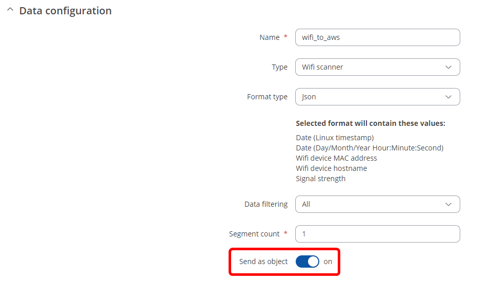

In the Data to Server configuration, there is a toggle whether the data is sent as object:
This option will change whether to send the data with square or curly brackets.
Alternatively, instead of selecting Format type as JSON, custom format can be used with the needed configuration, where the data format and symbols can be specified manually.
Perhaps I missed some information or formatting issues?
Hi @Daumantas ,
We fixed it by disabling the toggle and the custom format. Thank you!
