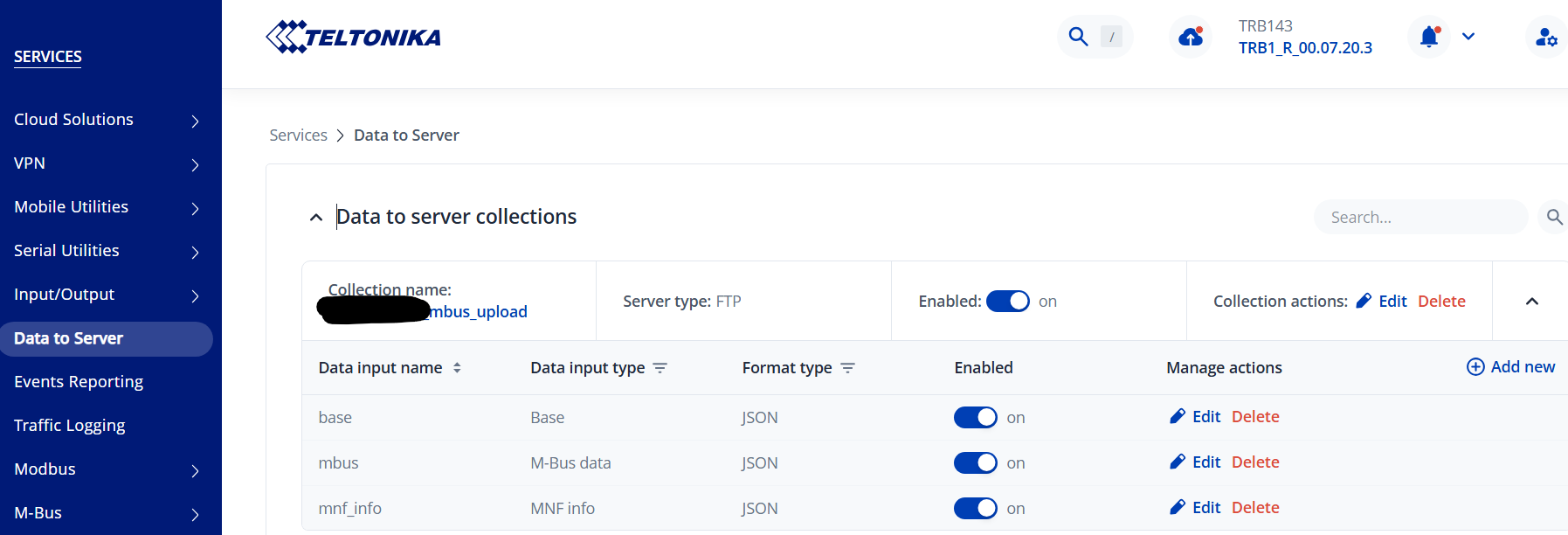

The Router is reading MBus data into a collection group.
The data is pushed to an FTP service via the data-to-server function.

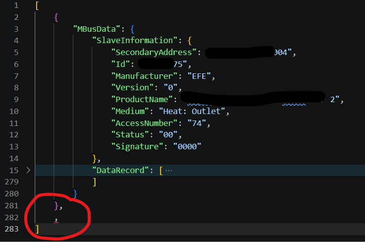

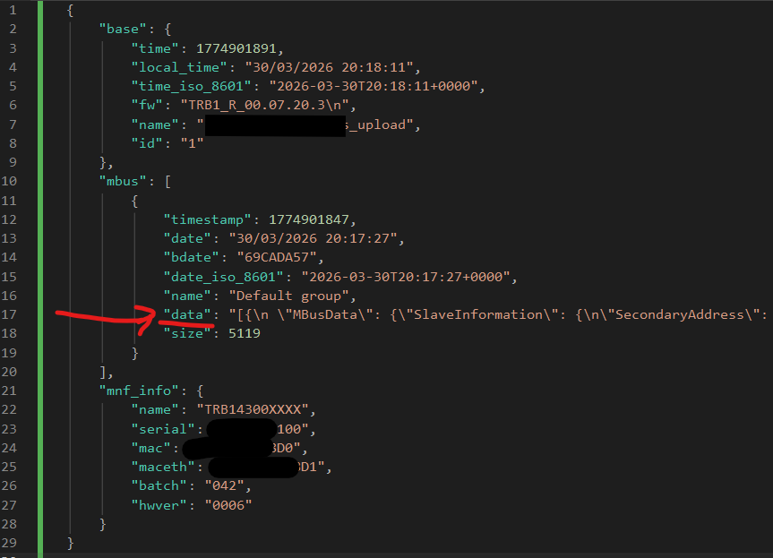

Within the MBus data, two invalid ‘,’ characters are used, making the content invalid.
Here the “data” string content unescaped:
I think I can exlain the reason, but its still a bug.

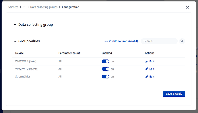

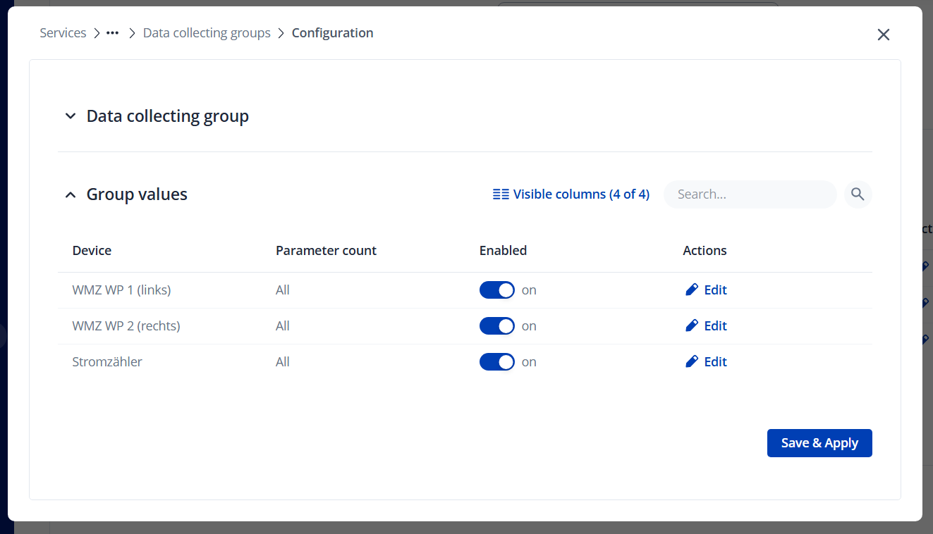

I have 3 MBus devices connected:

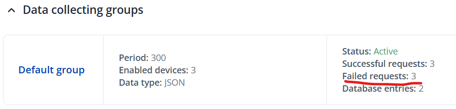

Some times some device have problems to be reached:
If a device is not reachable (no data) the data to server function still contains a ",” for each segment (device).

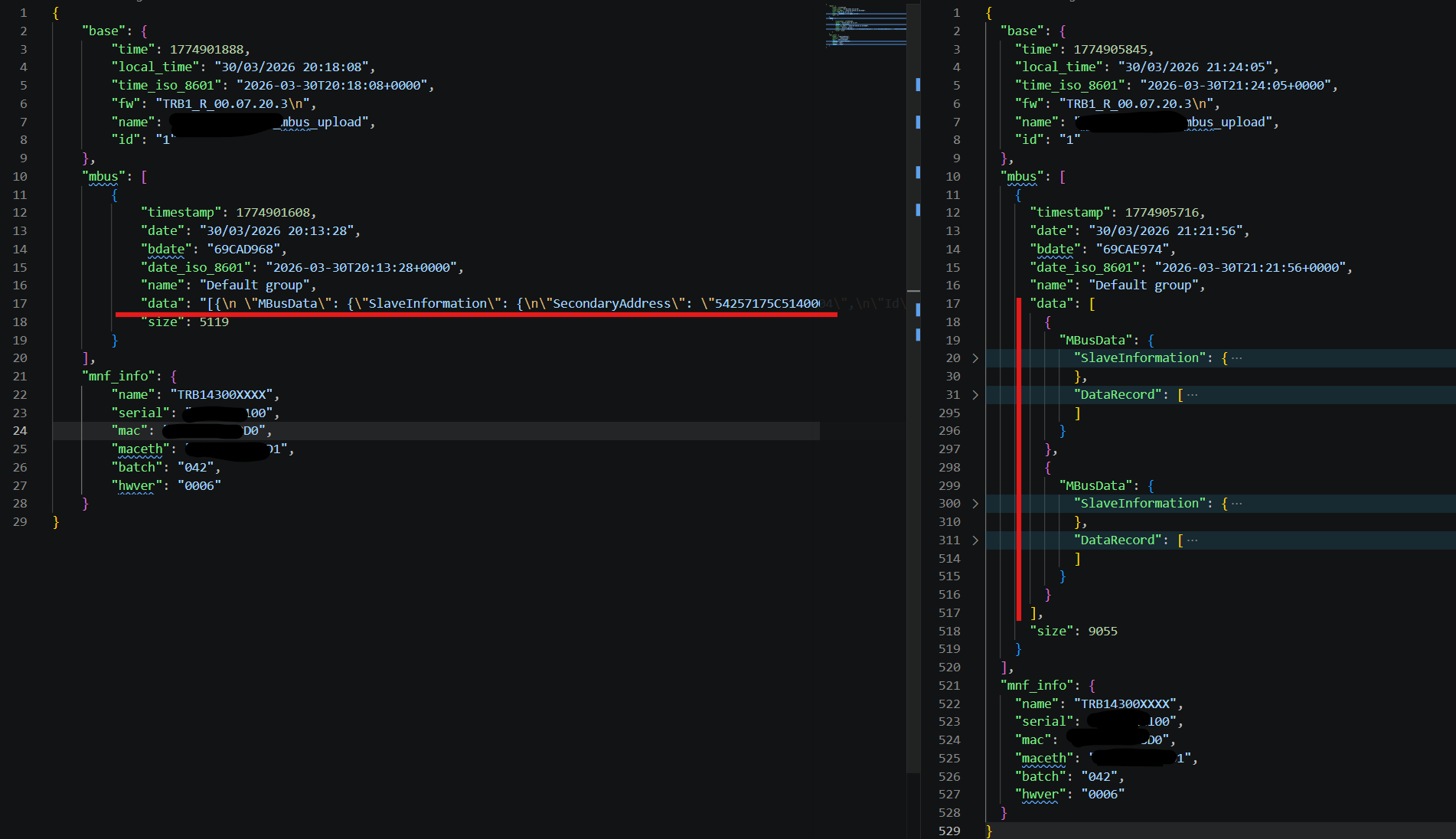

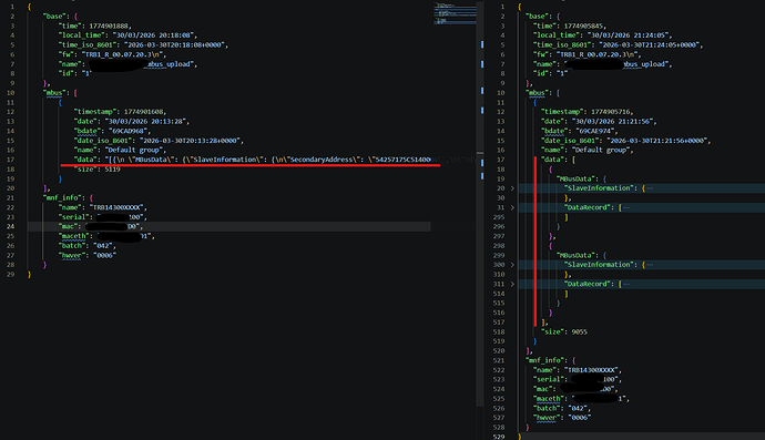

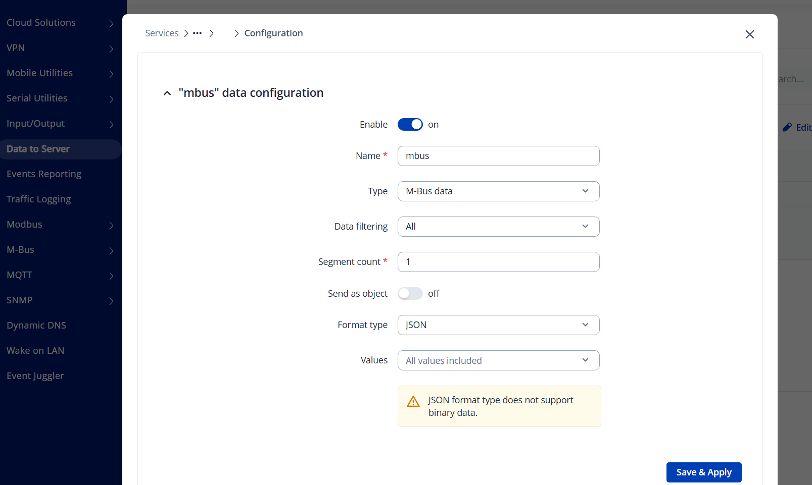

What is also strange is that depending on the max segment count choosen the MBus data property is formated as escaped json string or jsong object content.
Left: 1 segment, Right: > 1 segments
Update: I switch the setting back to 1 segment. But the “data” content is now still JSON object.
For weeks before “data” always contained this (left side) escaped JSON string.
Was that a bug or what is controlling the form?
As a side effect the complete JSON is valid again. To the problem only happens inside the escaped JSON string. Even more important to understand.

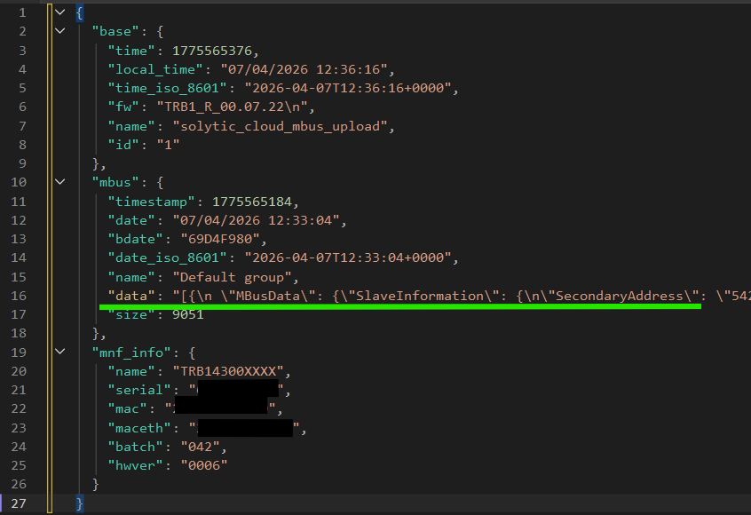

Update:
After updating the firmware it switched back to escaped string
I’m so confused.
