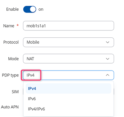

Have you tried to go for 4G only and/or IPv4 only?

Will need to try the Ipv4. I have tried all available combinations of available ”G”. No luck. I don’t think it’s the Sim, as the router shows all details correctly. The only thing that seems wrong is the “Data connection state: disconnected”.
No help with IPv4 or the other tips. Tried with all Finnish operators and for all with 5G only, 4G only and auto. Tried factory resets. The device picks up the sim details correctly (imsi, iccid, msisdn). The mobile cell info is also picked up correctly. Is there a way to reboot the modem? I don’t have the skills nor the tools to update the modem firmware. Do you know if there is a a way to contact Teltonika directly? I don’t want to pay for some extra subscription to RMS if the product has a problem. Like said, haven’t done any changes to the device. It used to work and all of a sudden just stopped.
