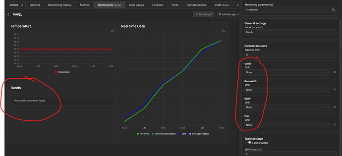

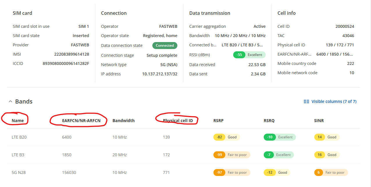

I’m trying to build a widget that can display the “Bands” data as shown in the image. I can’t find the Bands Name, EARFCN, Bandwidth, and Physical cell ID parameters.
How can I do this?

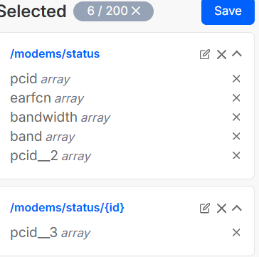

You will need to create a template, to view your required data like pcid, bands, earcfn and bandwidth. Information on how to do so here : Template:Create monitoring template - Teltonika Networks Wiki
After creating the template, when you go to your widget screen, you can add the values chosen in this template, to be viewed in the created widget.

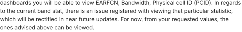

Update to the previous message from RnD :
Using this method, having installed the newest firmware, creating a template as advised above, then enabling that template via monitoring options, and creating a widget for it in dashboards you will be able to view EARFCN, Bandwidth, Physical cell ID (PCID). In regards to the current band stat, there is an issue registered with viewing that particular statistic, which will be rectified in near future updates. For now, from your requested values, the ones advised above can be viewed.

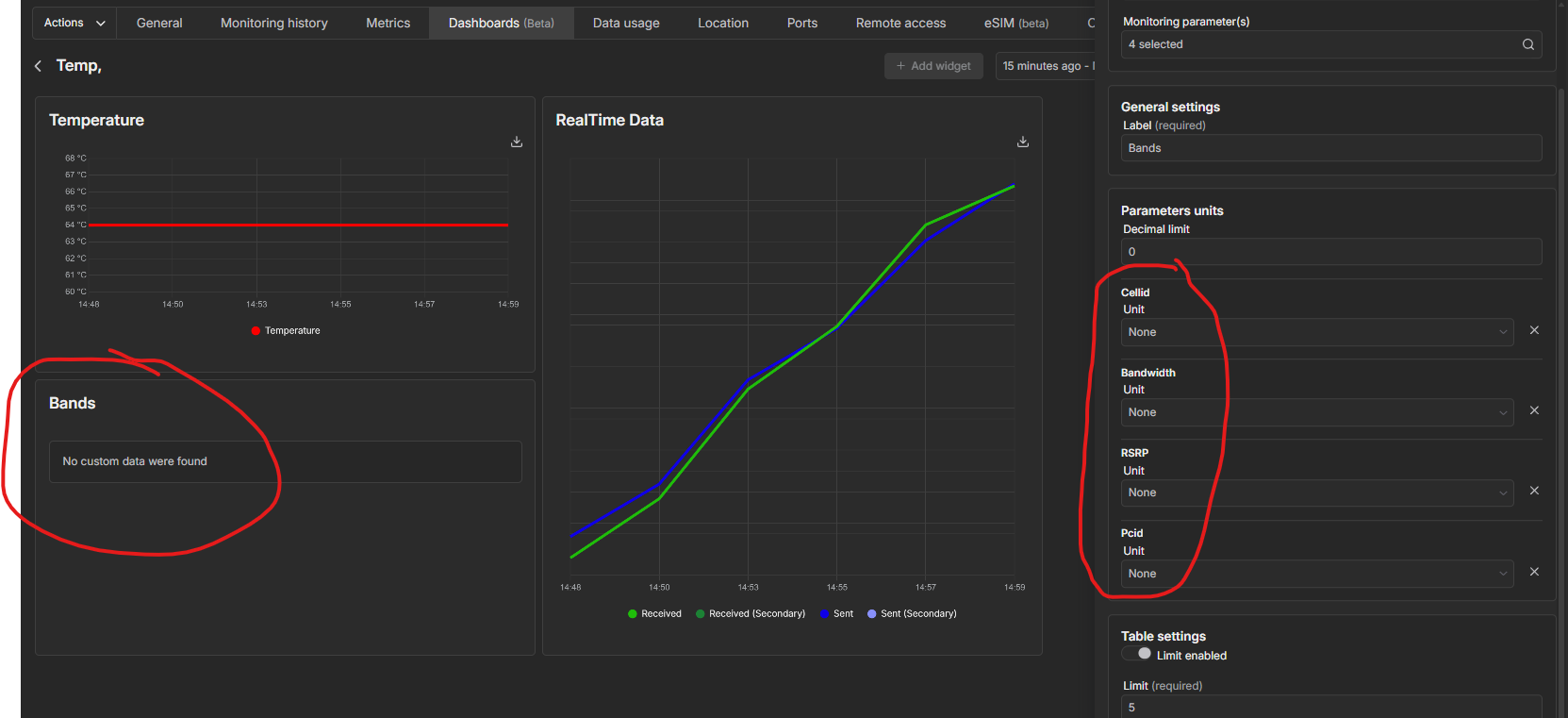

I Created template with parameter, in the custom widget there is message “No custom data were found”
