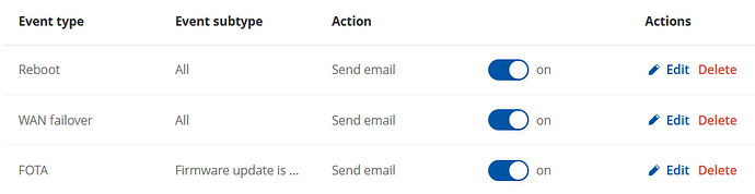

Most likely, you have configured Event Reporting, which can be found in Services → Event Reporting in the WebUI.
Please let me know if you need any further assistance.

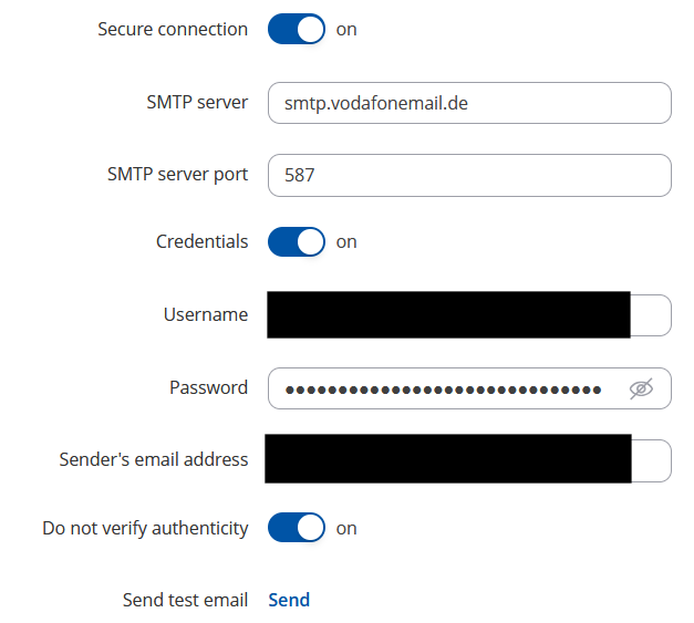

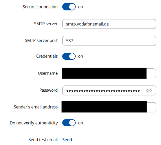

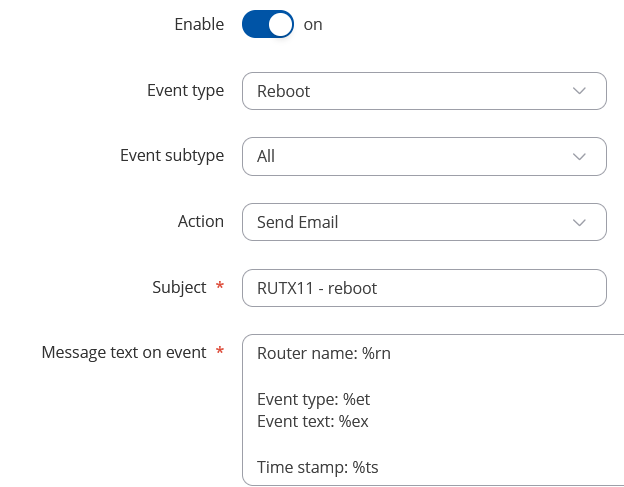

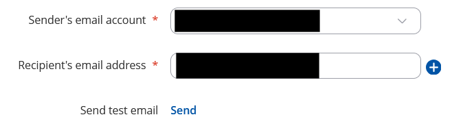

Yes, I have done that, as I described above:
The Send test email action under Administration > Recipients > Email Users > Account name is successful

In detail:
(same for the other events)
Could you please let me know which email provider you are using (e.g., Gmail)?
Vodafone - set up as follows under email recipients:
The Send test email successfully sends a test email. And it does, too, when sending a test email from the 3 defined events reporting configurations that I showed in an earlier screenshot.
