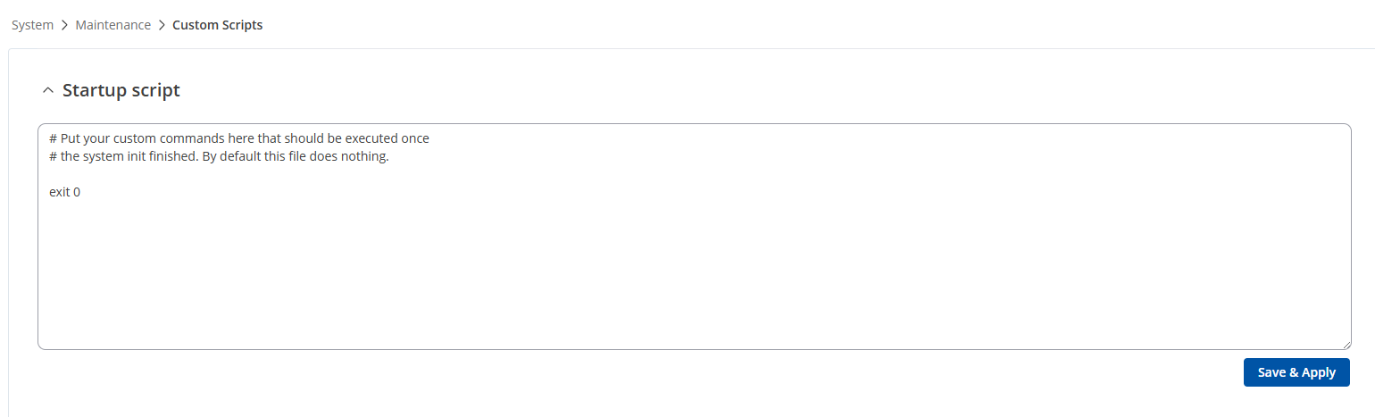

Usually I add my code to the Startup script section like belowe:
Do you mean that instead of just adding the code here I should instead make an executable script that I then call from this startup script section?
