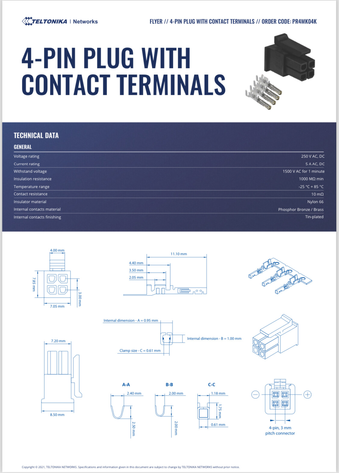

Does anyone knows what should I purchase in order to crimp a PR4MK04K 4-pin industrial power connector (Spec attached)
An exact module will be appropriated
(I am not sure if it is a Molex crimping tool or other)
