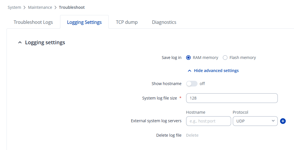

Hello there,
In my mind, there are 2 ways for you to achieve this:
  1. Set up a remote server where your logs could be saved:
Since normally, system, mobile, and other logs are all saved in the RAM memory, when the device is rebooted, they are cleared. Usually, when we troubleshoot issues, we ask clients to send their Troubleshoot files, which can be downloaded from the System → Maintenance → Troubleshoot → “Download” directory. This specific file is also cleared after a reboot so keep that in mind.
  1. The second way would be to write a custom script (which is out of our scope, so I’m unable to provide much support with this), which would essentially utilize the “grep” functionality & would then collect those specifically filtered logs and save them into a file, which you could then potentially send to a server, and then automatically delete it.
