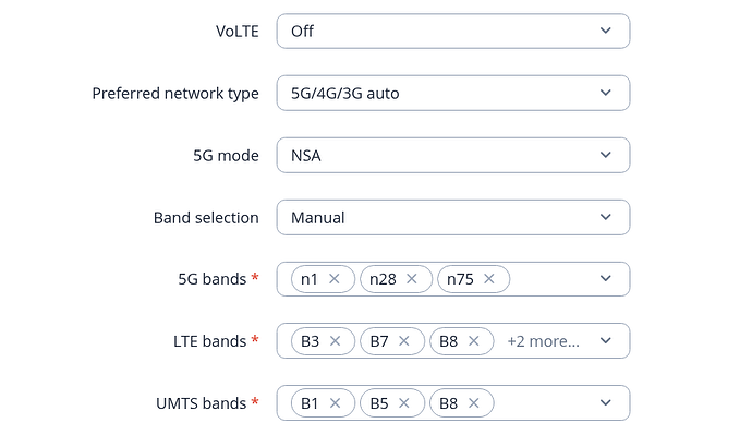

Hey sry, but these problems actually fully disappeared after hard coding the APN and its Connection Settings:
