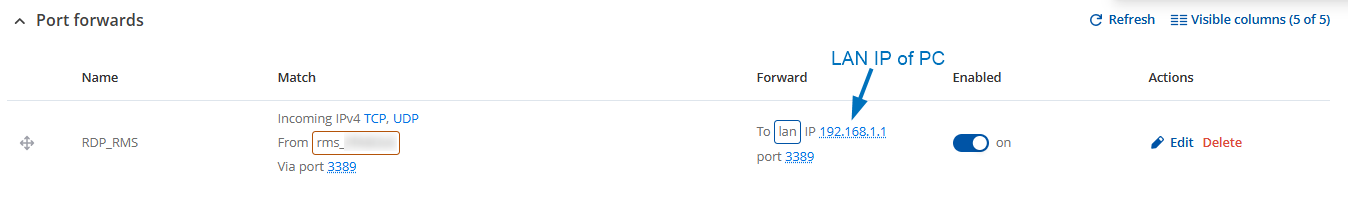

Furthermore, is the RDP port (3389) open on the RUT firewall? In other words, have you tried configuring a port forward from RMS VPN to that specific IP of the PC. For reference I leave a screenshot and configuration example for port forwarding:
