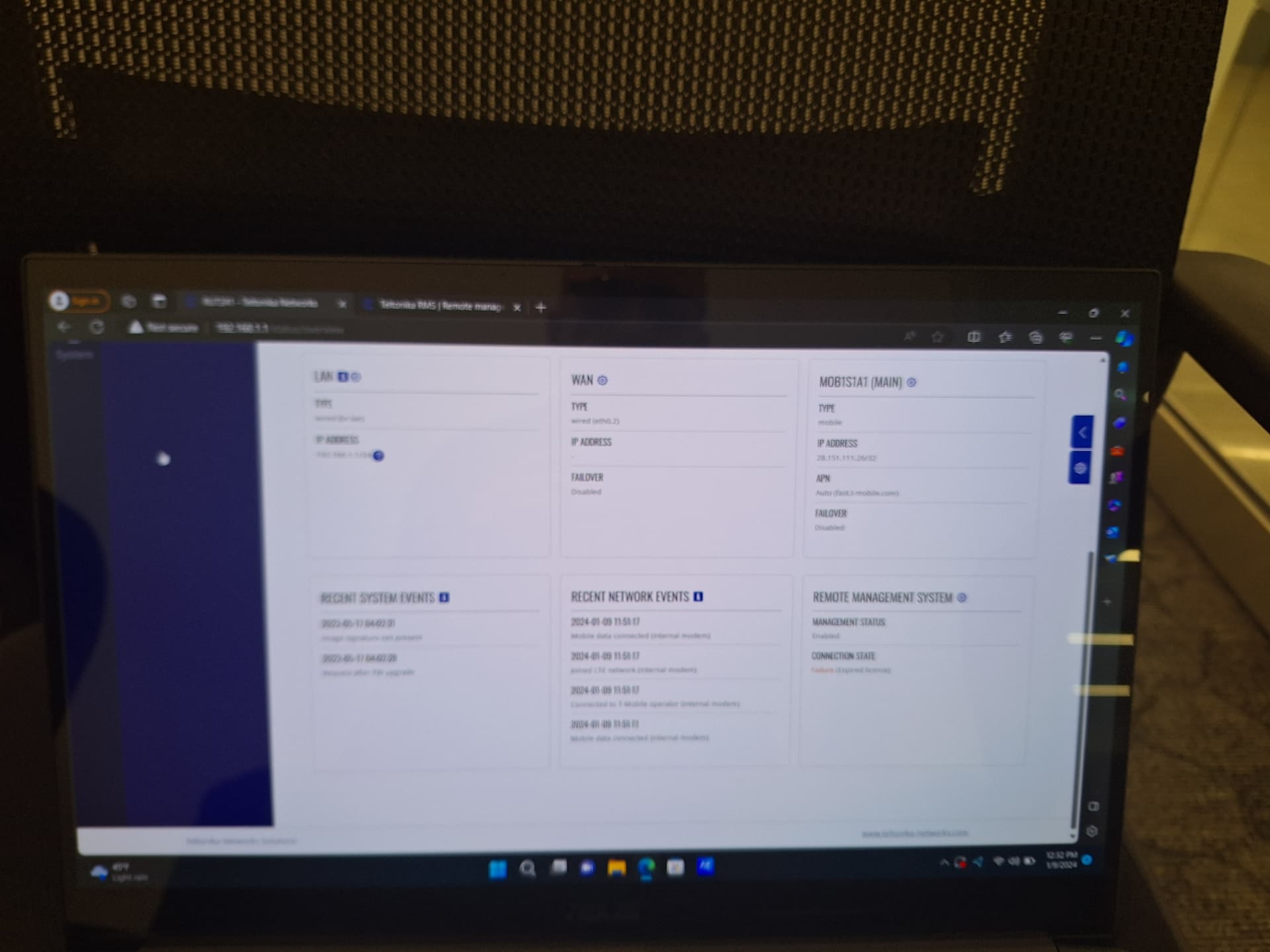

I am trying to help a customer enable the gateway access to the RUT 241_9BB7 device.
However, we are stuck at the "Connection state - Failure (Expired License) message after trying to connect.

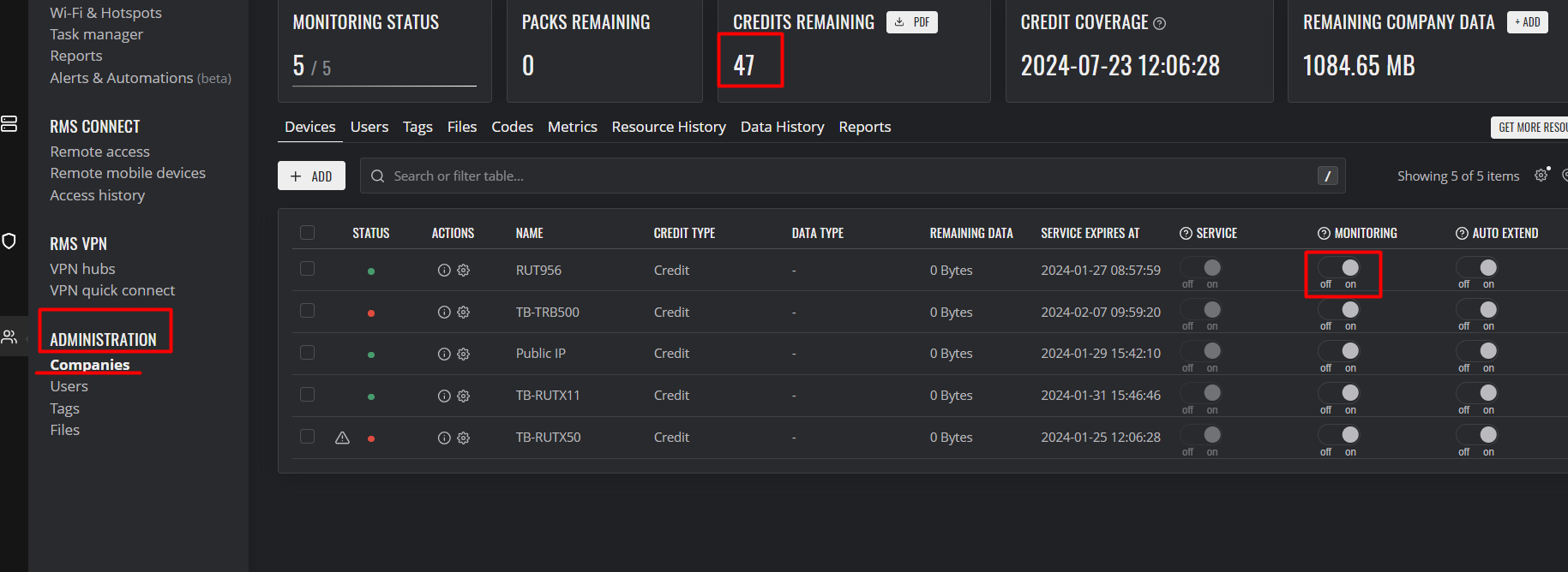

Regarding your query, This error message usually comes when the account is out of credit or when the credits are not assigned to device. Could you kindly check and let us know if the account has credits and the Monitoring has been turned ON

Sorry for the misunderstanding, The connection state failed is shown for our RMS (remote management system) This should not interfere with the router capabilities
It shows the failure as you have not linked it with an RMS account.
Let us know if you are using this service, if not this will not be a concern,
