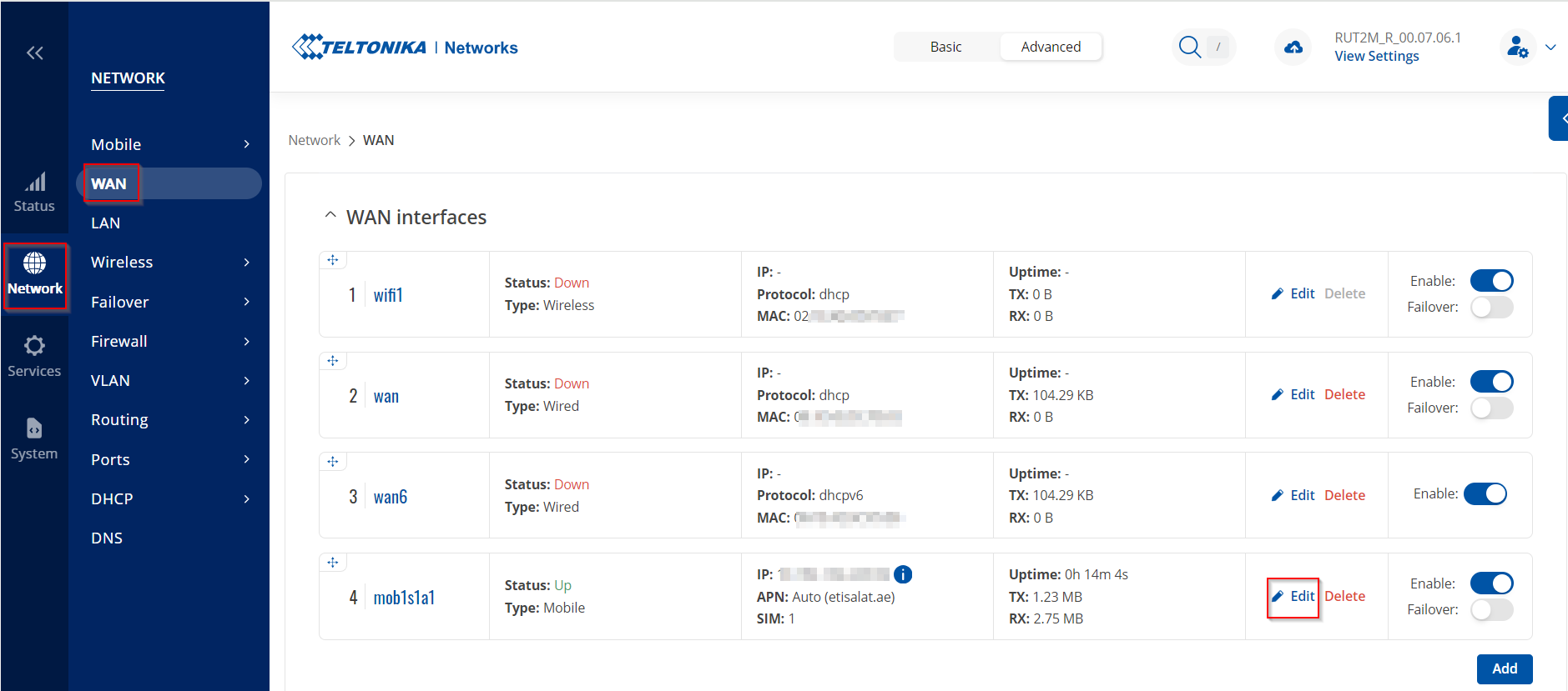

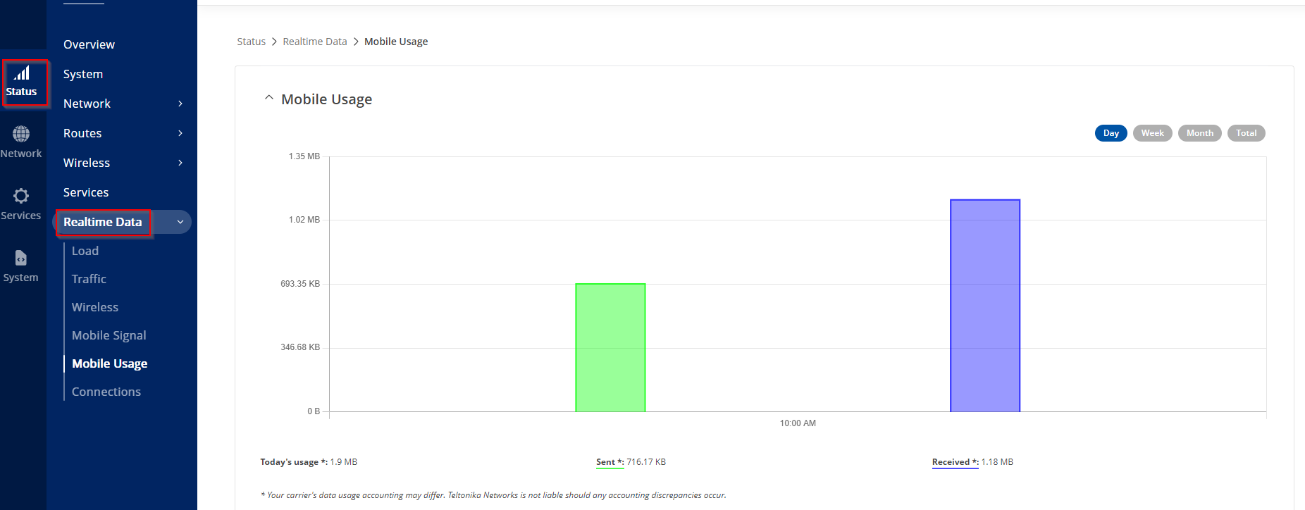

You can keep track of mobile data usage through a web-based interface, as shown in the image below.

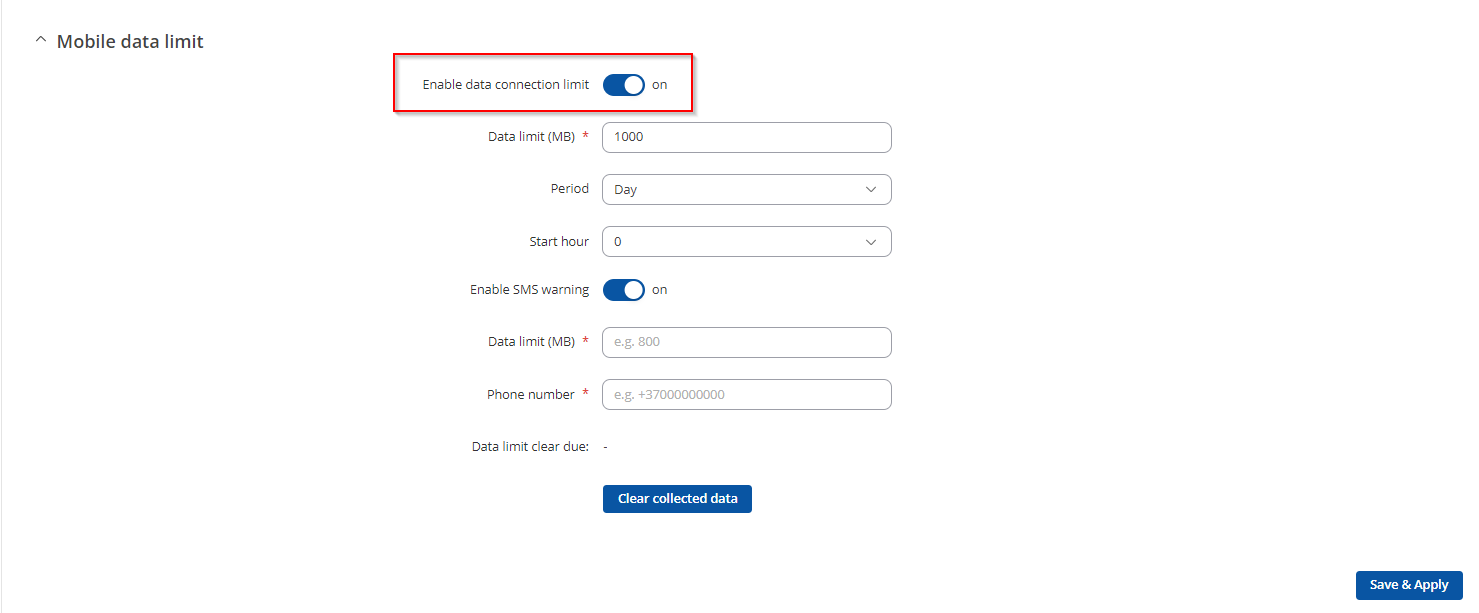

You can also set data limitations using the provided features.
You can Enable the data connection limit as well.
