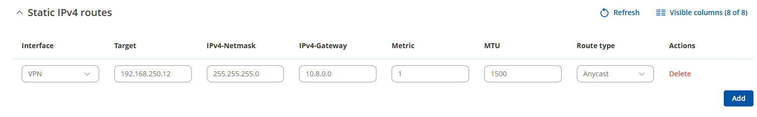

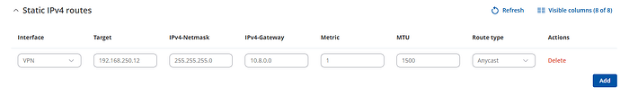

I have a single route to try and reddirect but did not work,
