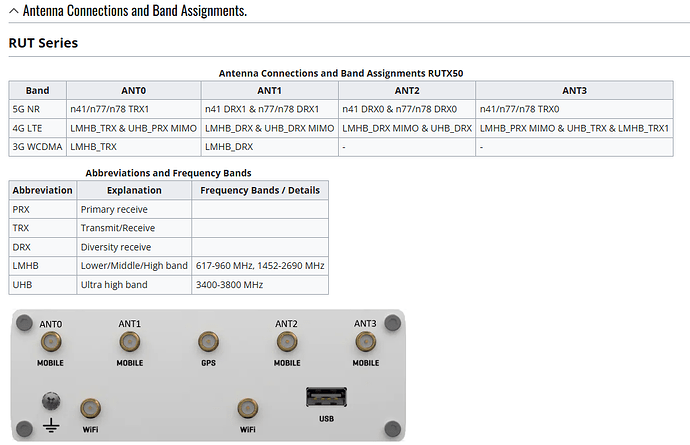

Regarding 5G antennas, all four mobile antenna ports are considered MAIN ports
  • Ports ANT0 and ANT3 are TRX (Transmit/Receive).
  • The middle ports (ANT1 and ANT2) are DRX (Diversity Receive), which enhance signal reception but do not transmit.
  • For the best performance, it is recommended to connect antennas to all four ports.
  • If connecting only two antennas, prioritize ANT0 and ANT3 since they handle both transmission and reception (TRX).
Based on your description, cell 1 main and cell 2 main should be connected to the ANT0 and ANT3 ports, while the remaining aux/div connections should be connected to the ANT1 and ANT2 ports.
You can find more information here:
5G Mobile Antennas - Teltonika Networks Wiki
