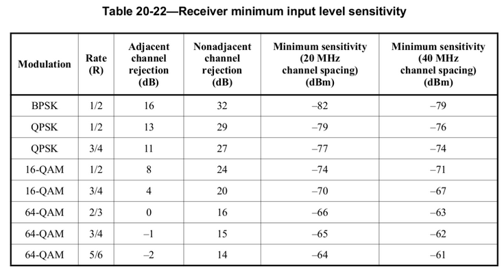

I managed to find these statistics(2.4GHz):
