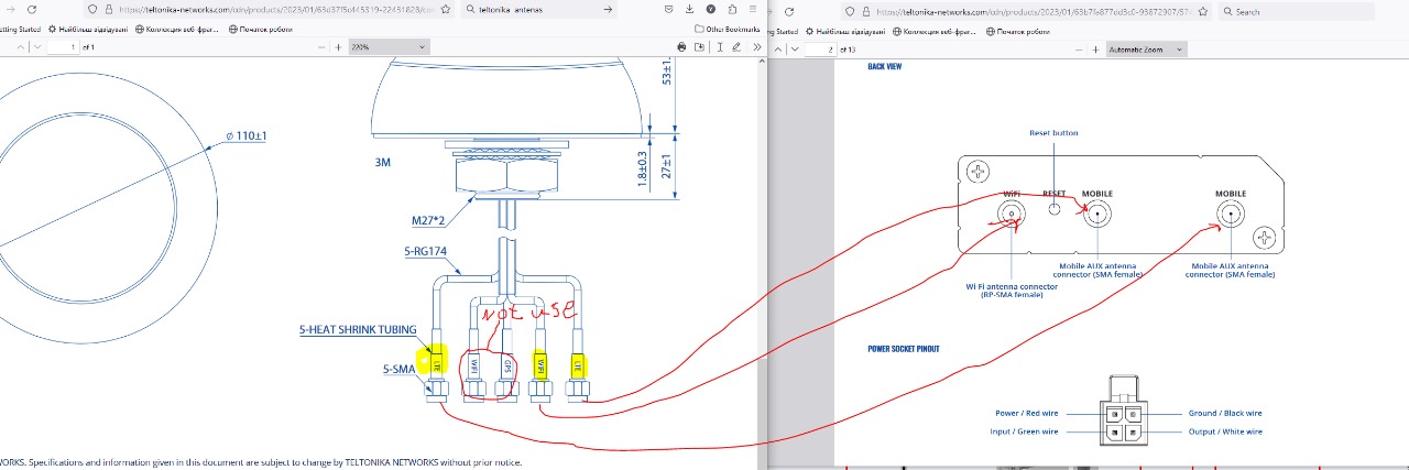

Hello. I have RUT241 and PR1KCO28 (COMBO MIMO MOBILE/GNSS/WIFI ROOF SMA ANTENNA).
The characteristics of this antenna indicate that it is compatible with RUT241. But the problem is that RUT241 has only 3 inputs (two mobile and one WiFi) and the antenna has five ends (two mobile, two WiFi and one GPS). I don’t connect GPS, but which end of the WiFi antenna should I connect? Can I cut the antenna wires that I will not use?
thanks
Hi, Any WiFi antenna should work. In case I’m wrong, you could always do a trial and error and check if the WiFi strength is improving.
For the other point, I wouldn’t recommend cutting the unused cables unless there’s space limitation or something.
Because in my case, I have both RUTX11 and RUT240. I can use the same Combo MIMO on both. In the future, you might buy another device that has 2 LTE and WiFi antenna ports where you can use the MIMO antenna on it.
