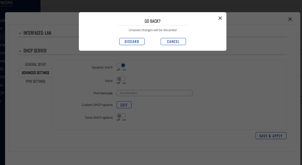

Bugs: The issue seems to be with MacOS Safari 13.1.2.
Network->LAN->Edit. The “Discard” button in different options does not work. In some windows the “Cancel” button also does not work. I have to use the browser refresh button to reset the page as I cannot continue with clicking either one of the two available buttons.
It seems to work with Firefox on the same Mac. Perhaps it is not a bug but unsupported browser of late? Previously on RUT firmware 7.4.5 this was not the case yet.
Have you tried clearing cache in your Safari Web browser?
Yes I have, still does not work
