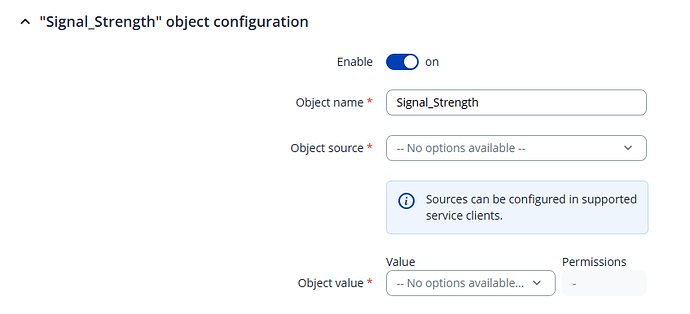

I want to read values like Signal Strength, Temperature, etc from the RUT976 into GeoScada and have configured the DNP3 Outstation to suit. GeoSCADA is reporting a good connection to the outstation, but I cannot add data sources to the outstation.
Do I have to create a DNP3 Client on the RUT976 pointing at itself and then have that client make requests to itself to be able to create the data sources in the outstation? When I tried this I killed the connection to the GeoSCADA server.

Greetings Vilius,
Yes, that is exactly what I expected the procedure to be. However, when I get to step 3 the “Source” dropdown is not populated with only the message “– No options available –”.
I feel like I’m missing something obvious.
Thanks, Ryan
