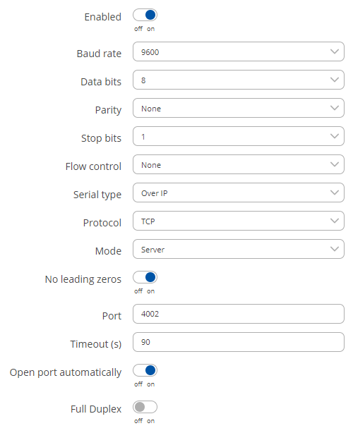

Additionally, you can find a full duplex connection example in the provided image:
000127
I ensure that the Over IP settings are configured correctly for proper functionality.
