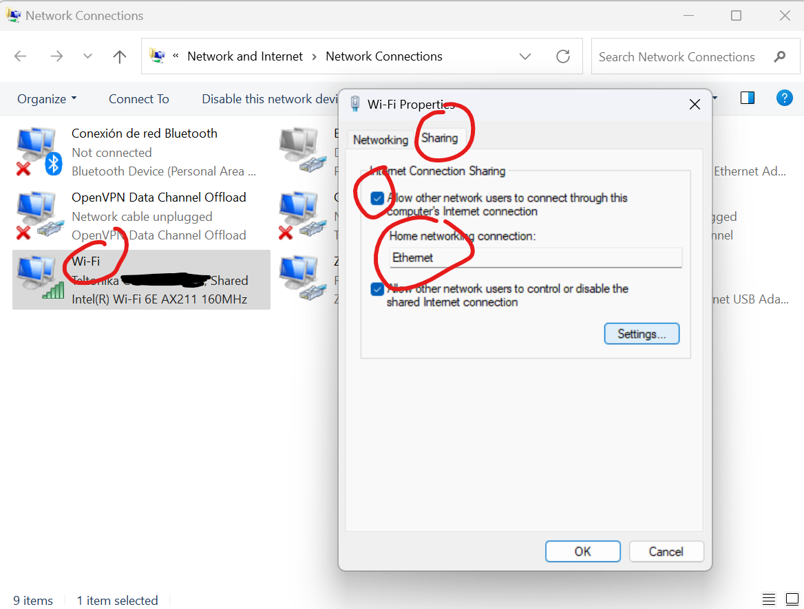

Hi guys;
@post thank you for the clarifications. This is what I did: using a laptop on Windows I set up the Wi-Fi NIC for Allow Internet connection sharing (Change adapter setting).

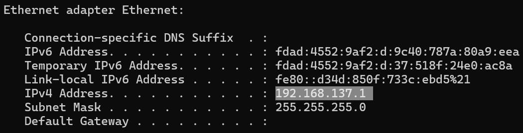

Then I check the new IP address on the Ethernet NIC:

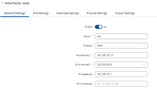

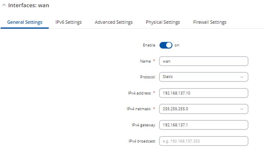

Therefore, I configured manually an IP address on the WAN port on the router (an ip that belongs to the laptop’s Ethernet network)
Finally I plugged the laptop to the Teltonika Router using Ethernet port to the WAN port on the router, such as the image below (just made sure you’re able to reach internet from your laptop):

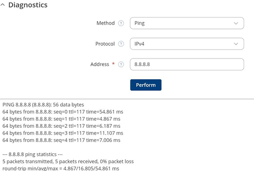

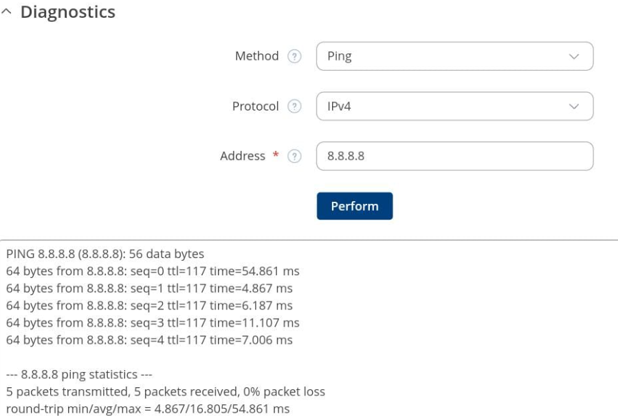

Please validate if you have Internet connectivity from the router:

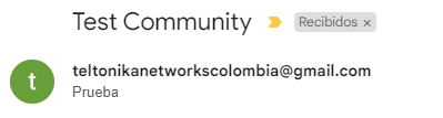

Now you can set up to forward an SMS.
Please tell me if I understood the problem correctly, and if this process helped you to solve it.
