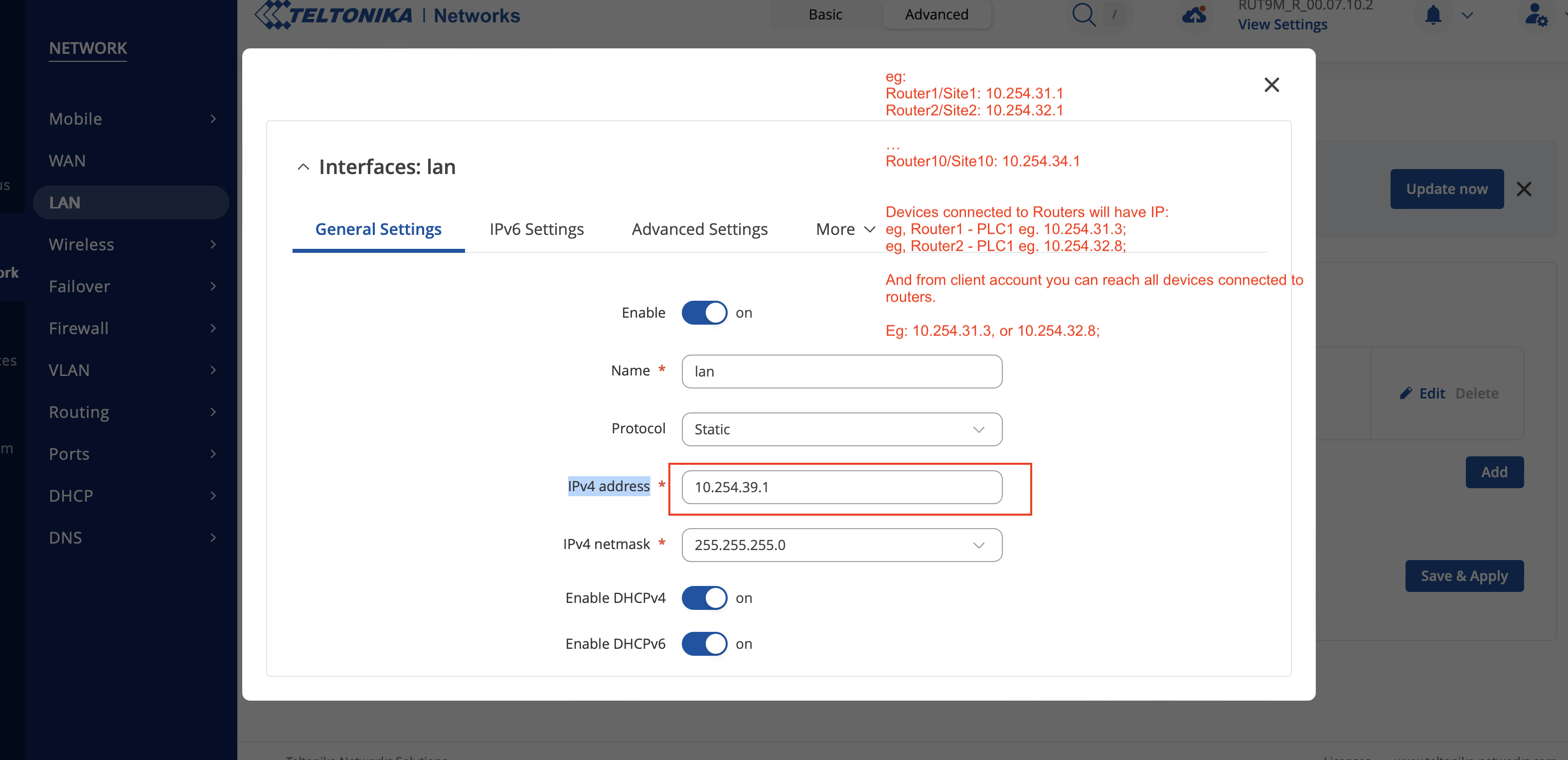

Change the IP of the router to 10.254.x.1

This is setup works, but has some security issue. Eg. if you client connects to the router of the site, he can also reach other sites. So some extra iptables rules needed.
