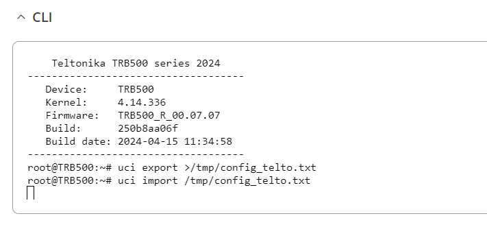

Hi everyone, i’m trying tu upload config file into a TRB500 but there is a problem, my CLI freeze when i do the command to import the config file.
i achieved it a week ago but now my TRB500 just freeze when i upload, any suggestions?

Hey,
Instead of typing:
uci import /tmp/config.txt
give this a shot:
uci import </tmp/config.txt
And remember to follow it up with:
uci commit
This commits your changes. After that, you’re good to reboot, and the changes should take effect.
