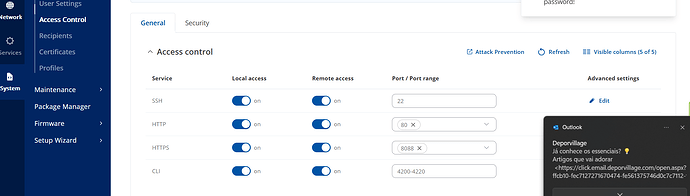

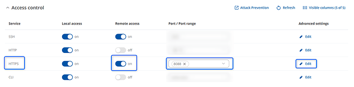

Assuming you’re trying to reach your RUT200 just by simply enabling the “Remote HTTPS access” option in the WebUI, you would need a Public IP address so that it is reachable from the WAN.

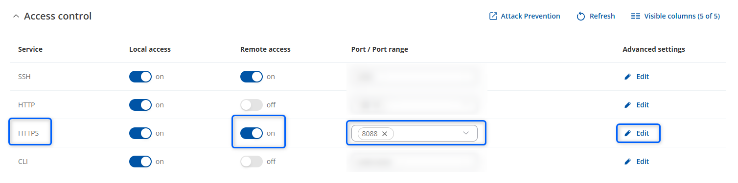

Head to System → Administration → Access Control
Enable Remote access for the HTTPS service
Set the Port to 8088, or whichever one you’d like

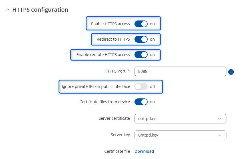

Press Edit on the HTTPS service:

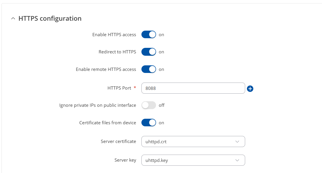

Make sure that your settings match mine:
After everything is configured, make sure to Save & Apply, and then attempt to reach the device via the PublicIP:Port, example: 11.11.11.11:8088

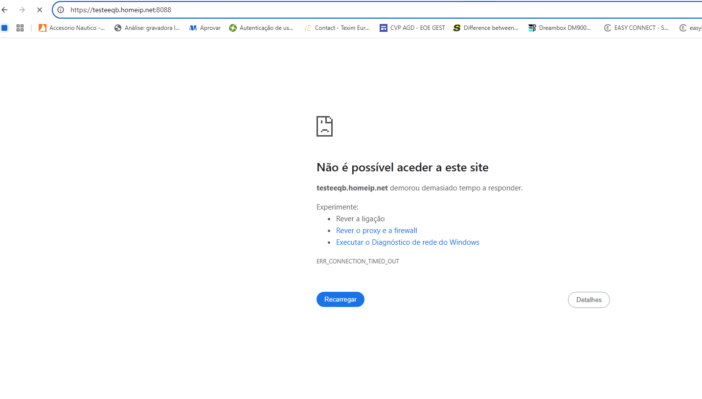

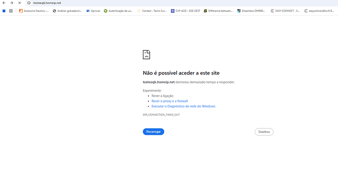

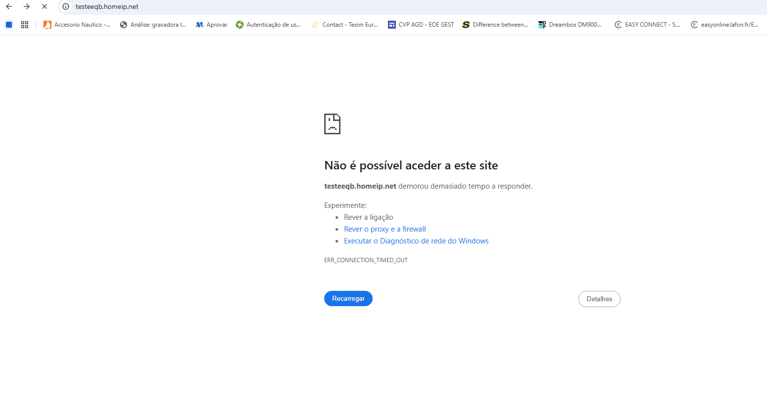

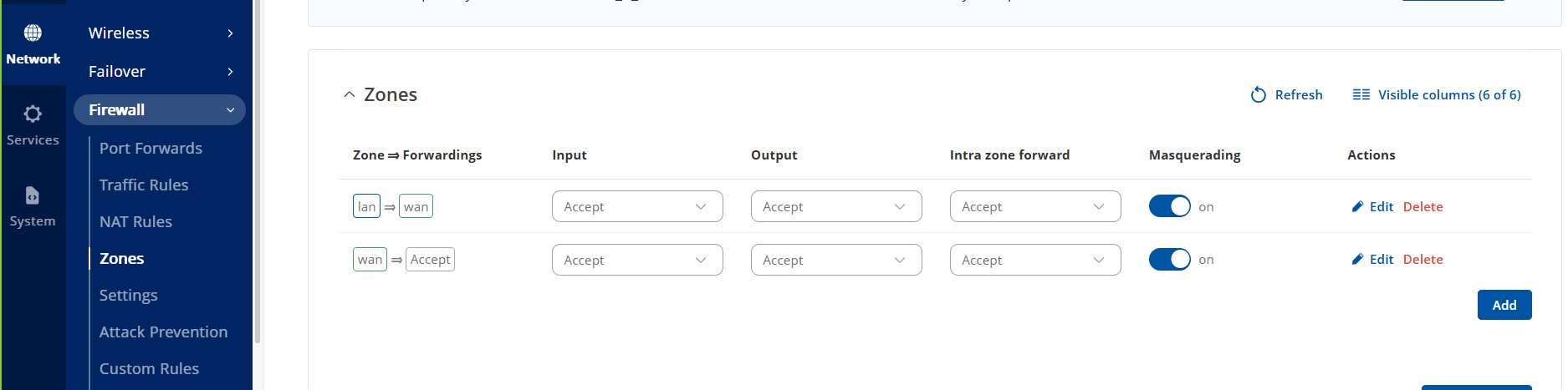

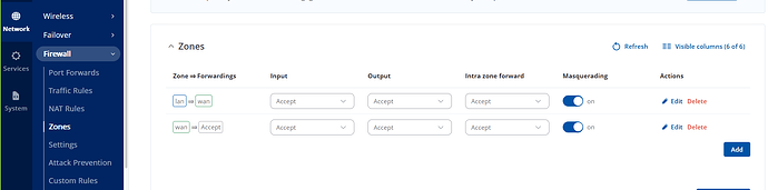

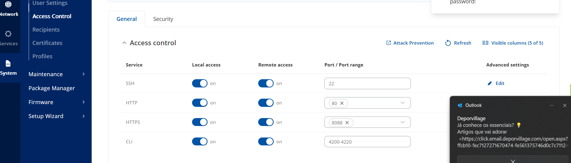

is not working… I try with a public IP or by dns service, a can’t reach.

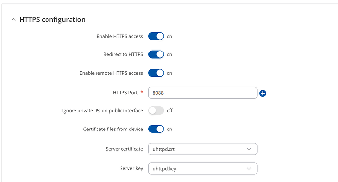

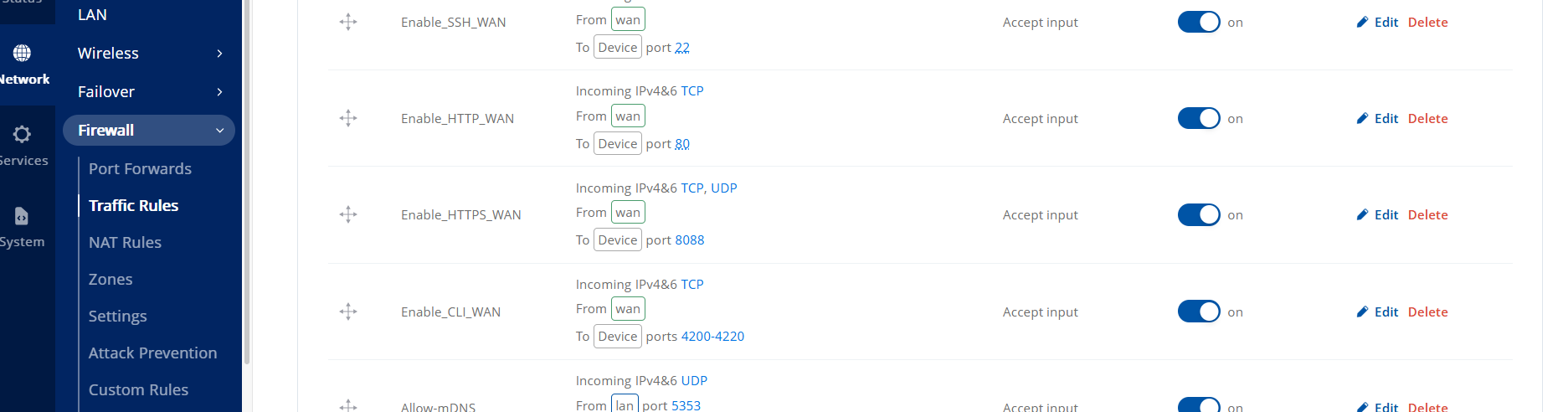

I guess it’s all ok:

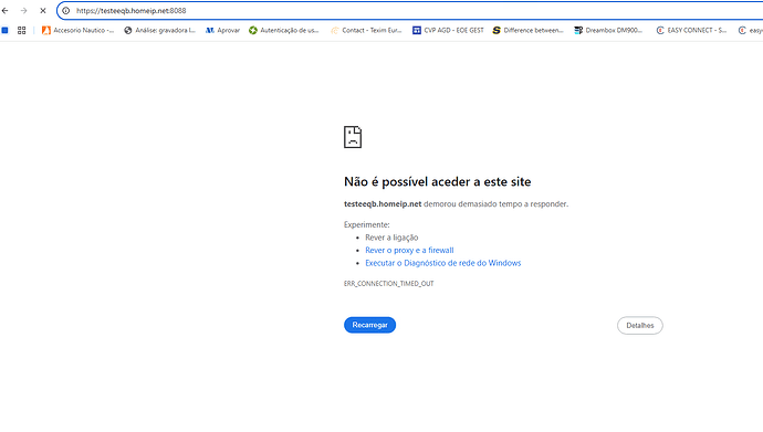

I have no access from outside.
I Try in https, and http, port 8088 or port 80
You are trying to connect using a DDNS hostname, which you did not mention at all. We have a guide on how to set it up here: RUT200 Dynamic DNS - Teltonika Networks Wiki

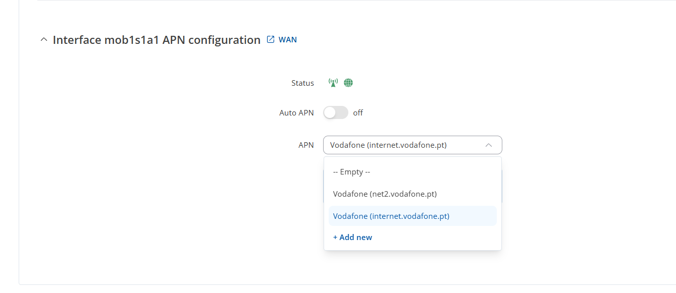

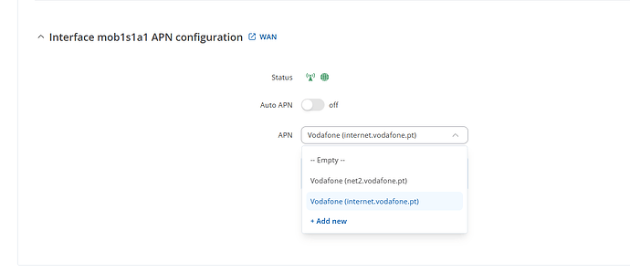

Finally i resolve the problem, it wasn’t about the router firewall or acess.
It’s about APN, I have switched AUTO APN, but it can’t be.
Must be manuel, and set APN → internet.vodaone.pt with the first i can’t reach from outside.
