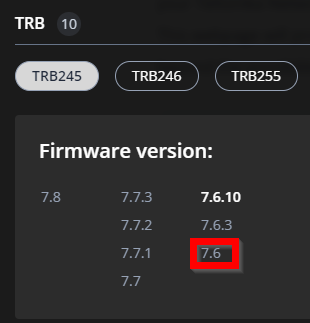

Please upgrade to the 07.06 firmware version, which officially supports the RUTOS API.
Also, ensure you are using the correct API call structure and the correct login data.
Hi again,
After the update, it works as expected.
Thanks a lot for the quick response!
