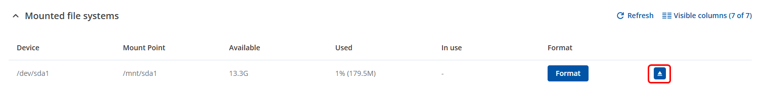

This can be simply avoided by unmounting the USB stick before a reset. You can either do this through the WebUI by heading to Services → SD & USB Tools and clicking on the arrow button as seen in the image below:
Or by entering the command umount /mnt/sda1
To check mounted USB devices, you can run the command mount | grep /mnt, which should give you an output similar (or the same) as this:

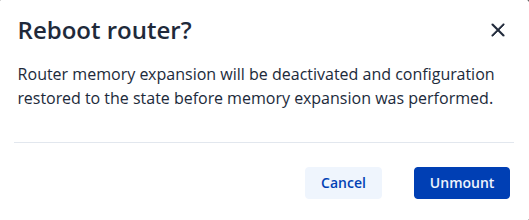

However, I don’t think your solution for preserving the storrage media will work. Using the WebUI produces the error
It might preserve the storrage media, but it will be erased when ‘storrage expansion’ is reenabled.

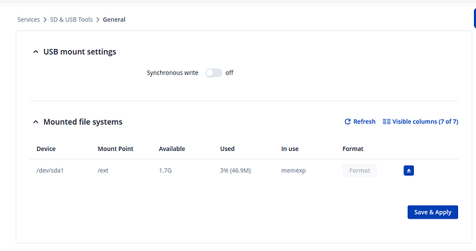

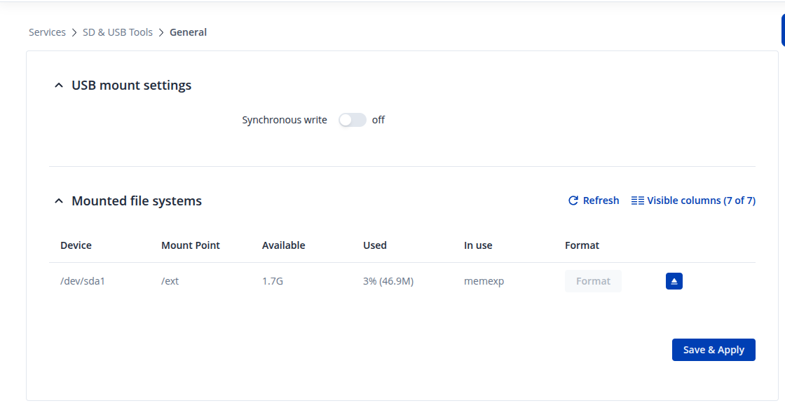

While the USB is mounted onto your device, could you please provide a screenshot of Services → SD & USB Tools → General?
Sure :slight_smile:
Regards Peter
Hi, Peter,
Thanks for the image. Looks like the directory for you is going to be /dev/sda1 - so the unmounting command is going to be umount /dev/sda1; Regarding re-enabling memory expansion & the contents being wiped, I’ll inquire about that with our R&D whether anything could be done. I’ll get back to you.
