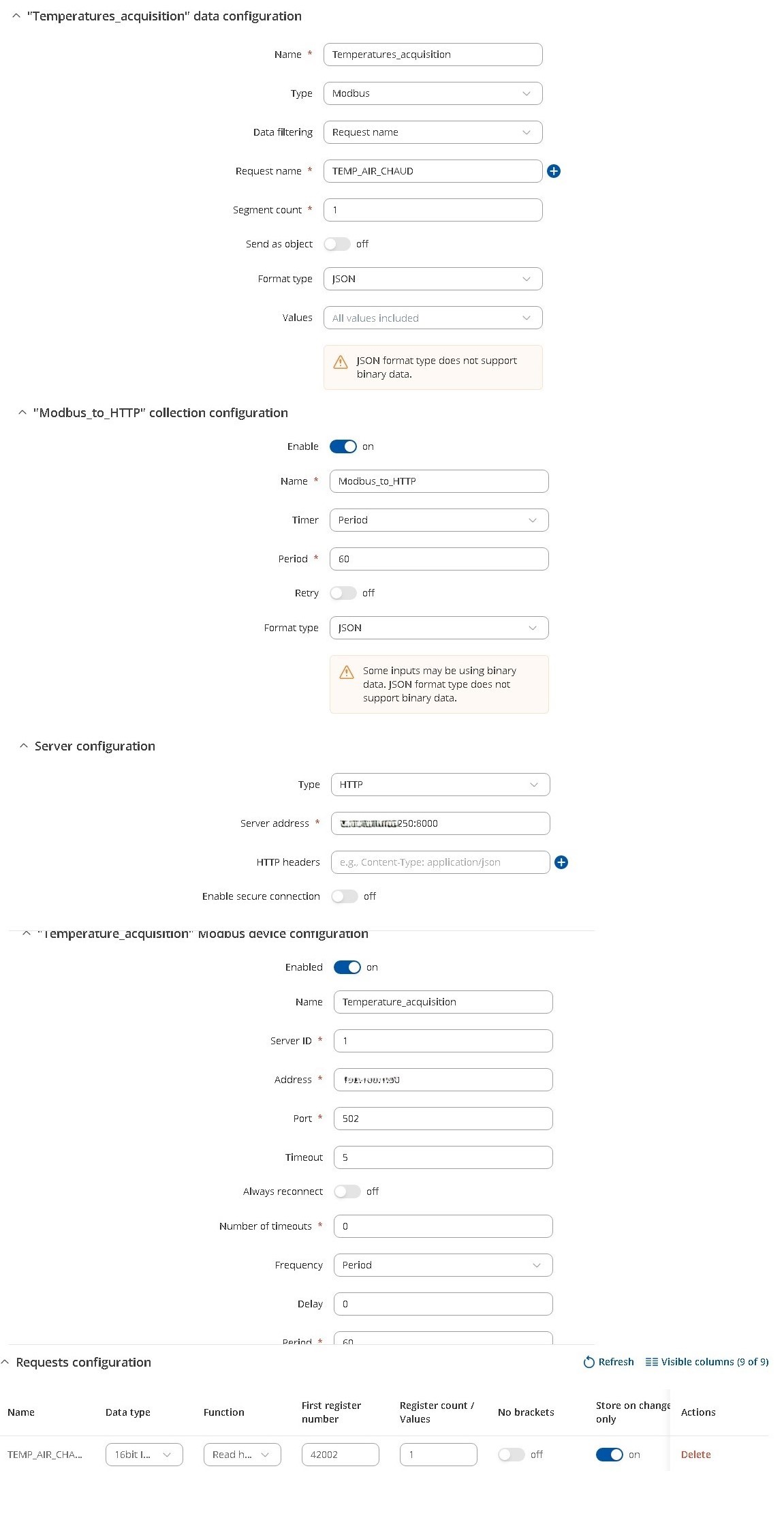

Thank you for your help, attached are the parameters set in the Data to server services and Modbus client.
Configuration looks just fine. Few things to note:
- Double check your authorization credentials (e-mail, password) for typos
- Double check the server port, whether it’s correct
- Ensure that the server you’re sending data to supports JSON as a format. Try different formats (other than JSON) as well for testing purposes.
