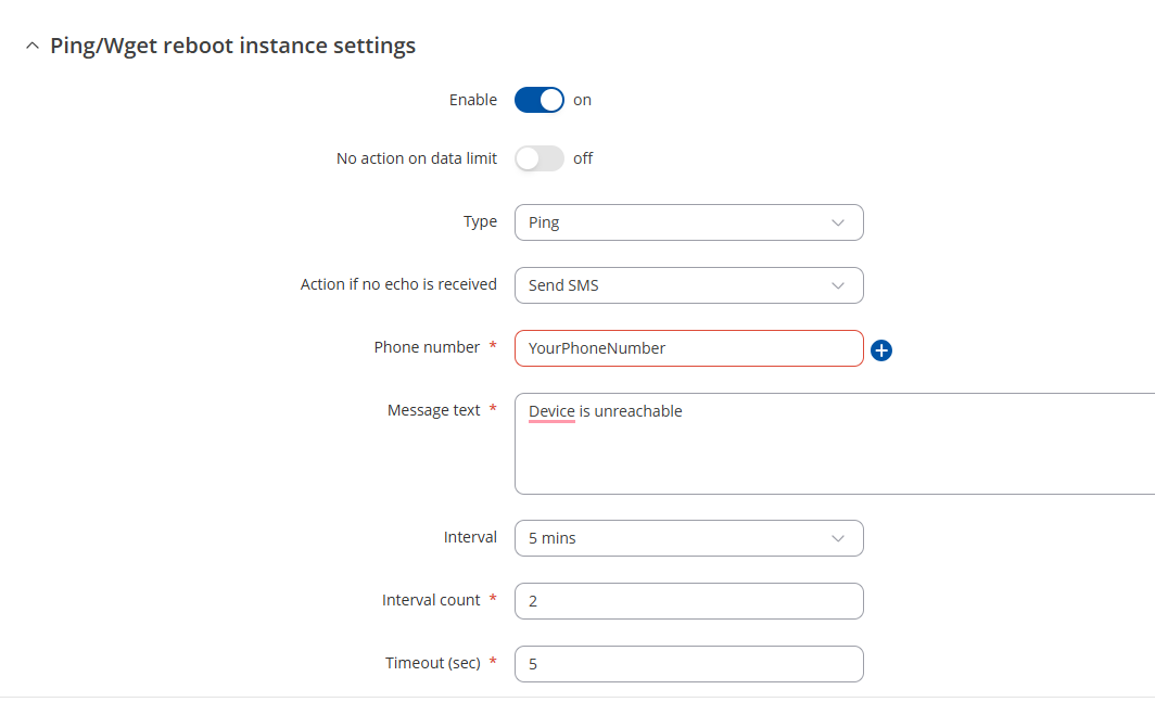

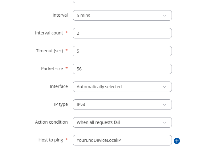

You have an option to set this up, a very easy one would be utilizing the Ping/Wget Configuration functionality within our devices: RUT200 Auto Reboot - Teltonika Networks Wiki
This can be set up to ping an x IP address every x minutes/hours, and if no response is received, it can:
- Reboot your RUT200
- Send an SMS
- Restart the mobile connection
- Reboot the modem
- (Re)Register with the mobile operator
As per the Wiki link provided above, you can set this up under WebUI â System â Maintenance â Auto-reboot â Ping/Wget reboot. Your setup would look something like this (of course, you can change it to your liking!):

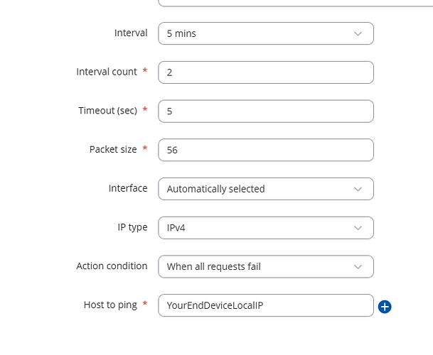

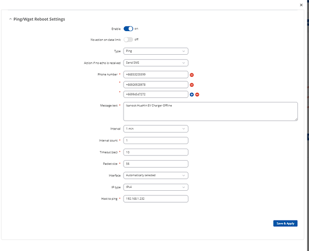

i have set up like this but it doesnât work, do i need another additional setting, and I doesnât see the âAction conditionâ
What firmware version are you running? If not the latest, kindly update to the latest and look for the option again.
Additionally, how are you testing whether this works or not? Are you simply disconnecting the end-device from the RUT200?

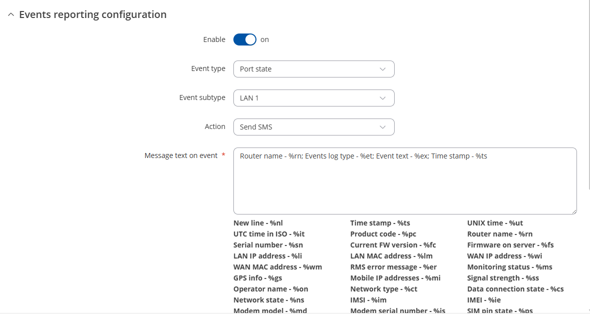

If the device âsometimes goes offâ, Iâd assume that the LAN port would also change its status to âoffâ. If thatâs the case, Iâd suggest trying Events Reporting: RUT200 Events Reporting - Teltonika Networks Wiki
I have âSend SMSâ chosen, but you can set up âSend e-mailâ instead.
