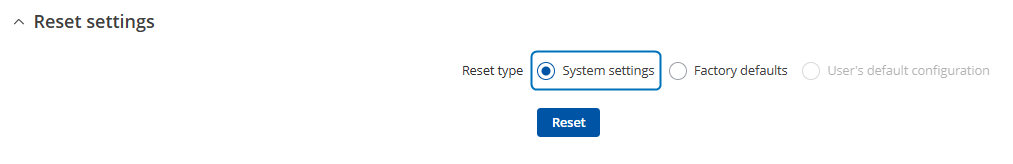

If you would want to have access to the device through RMS after the reset, then a system default reset should be performed, where in this scenario all the settings except RMS data (including necessary certificates), logs, and SIM pin will be deleted; however, device re-registering won’t be required, and you will have access to change the password immediately after it is reconnected to RMS.
System default reset setting:
Let me know if the issue was resolved or further assistance is needed.
