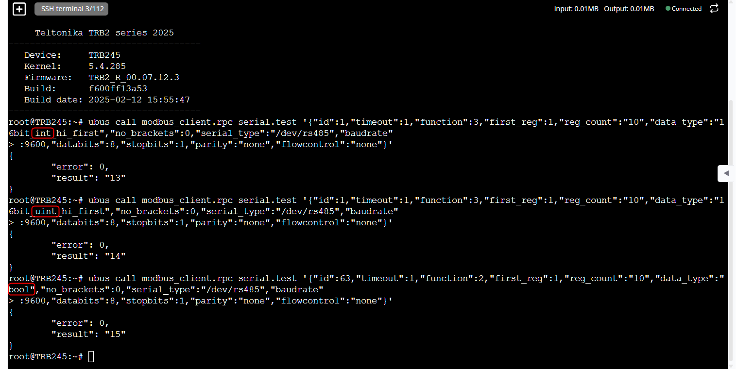

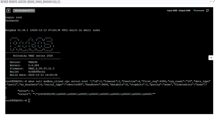

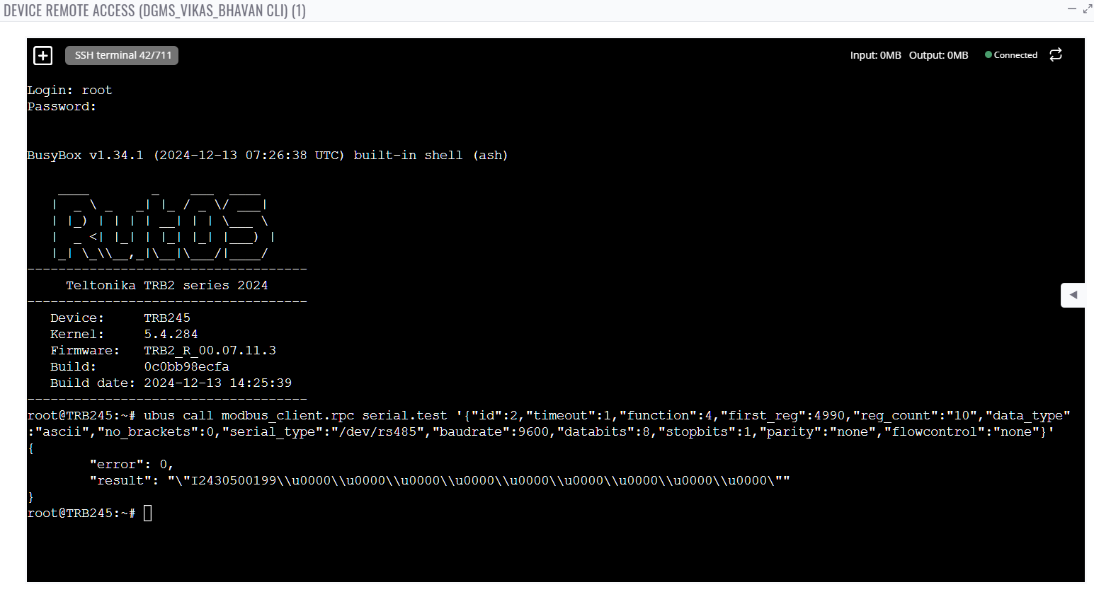

Before the firmware upgrade on TRB245, the data type ASCII was used with function 4 for reading input registers (first screenshot). Based on your description, for parsing data from sensors (which I assume are connected to TRB245), function 3 and data type 16bit_int_hi_first should be used.

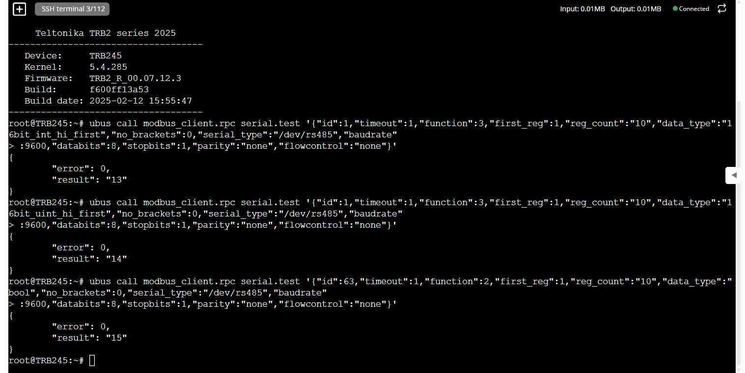

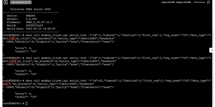

From your screenshot, it seems you are using different data types and function 2 (in the last command) in each Modbus RTU request:
Could you clarify how the Modbus serial servers (sensors, PLCs) are connected to your TRB and RUT devices?
Additionally, please double-check for any typos in the functions, data types, or other parameters in the ubus call modbus request commands. From the screenshots, the provided commands do not fully align with the ones listed in your description.
all the modbus serial clients are connected to RS485 terminals of respective TRB and RUT gateways in daisy chain. we have tested it repeatedly - it is found that till the firmware version TRB2_R_00.07.12 | 2025.01.20 - all ubus commands are returning correct values for each modbus register but when we install the latest firmware 07.12.3 of 14.02.2025 - the returning values is 0 for all ubus commands which seems peculiar to me. for existing TRB245 and RUT we are installing the previous firmware and closing the issue but what will happen when we purchase and install new gateway devices - do we have to maintain the same firmware. If yes - we wont be able to upload latest firmware for any of our new gateway devices.

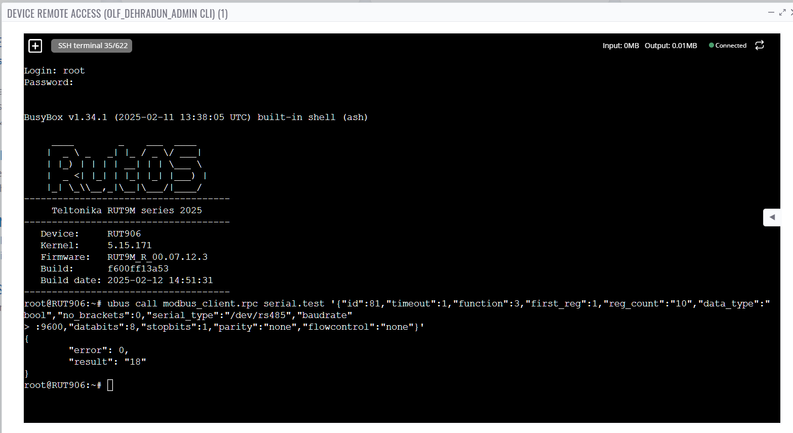

From your provided screenshots (ubus calls on TRB245 and RUT906), it does not appear that the returned Modbus serial server values are 0. The "error": 0 indicates that no errors occurred during data parsing.
Could you clarify and provide additional screenshots where the returned data is displayed as 0?
Also, just to confirm, does the issue not occur on FW 7.11.3, and does data parsing work correctly with that version?
