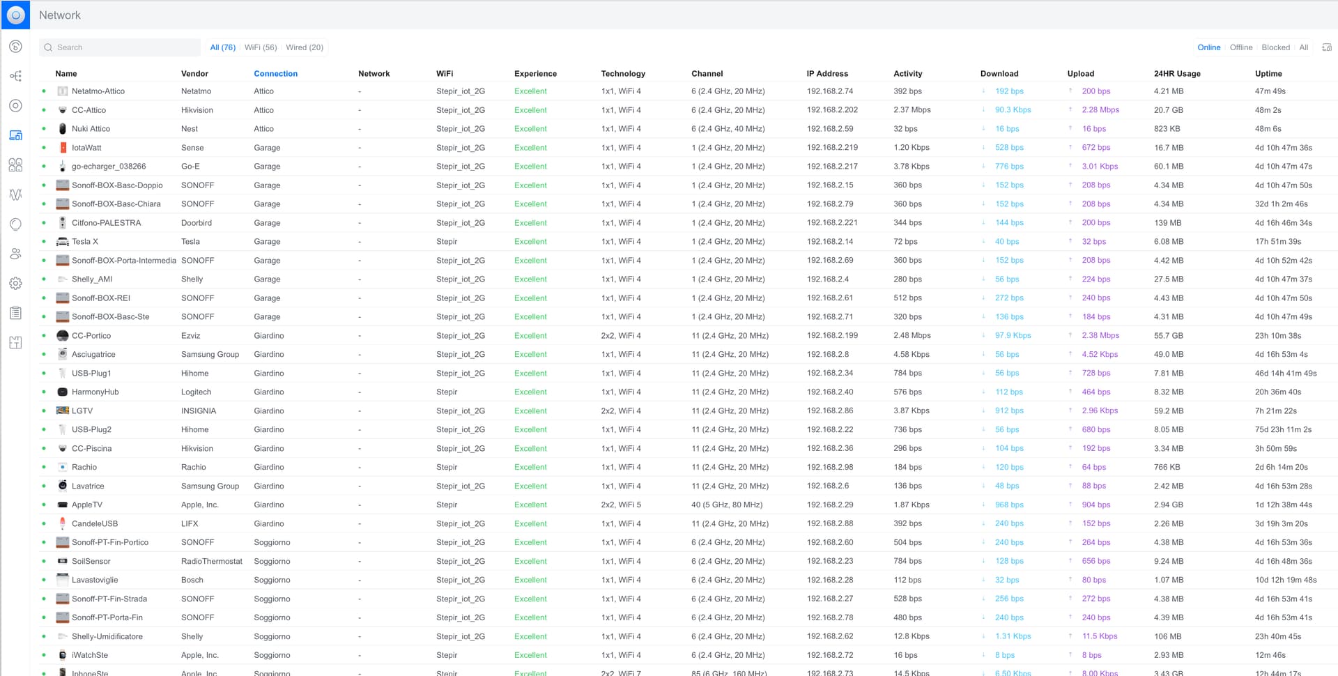

I have a RUTX50 and 2x TAP100 all configured to broadcast the same SSID.
My clients connect to the 3 AP “randomly” and I’m wondering if there is a way to have a central view of such? right now I have to login to the 3 devices independently and more over only the RUTX50 router report the hostname of the active clients, TAP100s report only the MAC Address which is just less useful to quickly identifies who’s connected to.
something similar would be helpful - how do people manage environments with multiple AP with Teltonika??
Hi, you could try the Status → Network → Topology functionality on your RUTX50 which should show all devices on your network.
Thanks!!! do you know if there is a way to get this info persistent? It seems I have to rescan devices all the time I visit its page, or the list of client is empty!
Hello @stepir75,
In the Topology view of the WebUI, pressing the Scan button is required to detect and display all currently connected devices.
Additionally, you can use the Network Map feature in RMS to visualize and manage all devices on your network. More information can be found in this video: https://www.youtube.com/watch?v=r58KQMr2rRw.
