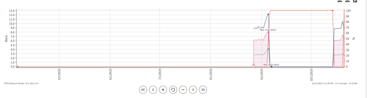

I have several TRB255/256s in the field that I monitor their cellular interface for traffic throughput and alert when it is outside of normal thresholds. However, it appears the teltonikas change their snmp interface OID after a reboot or reconnect. This annoyingly makes a dynamic interface that I have to re-add frequently. The traffic sensor I add looks like this
and after every reboot/disconnect the interface # increments. Occassionally it will come back to a previously used # and populate data again as below.
Anyone have any thoughts or repairs to this issue?
