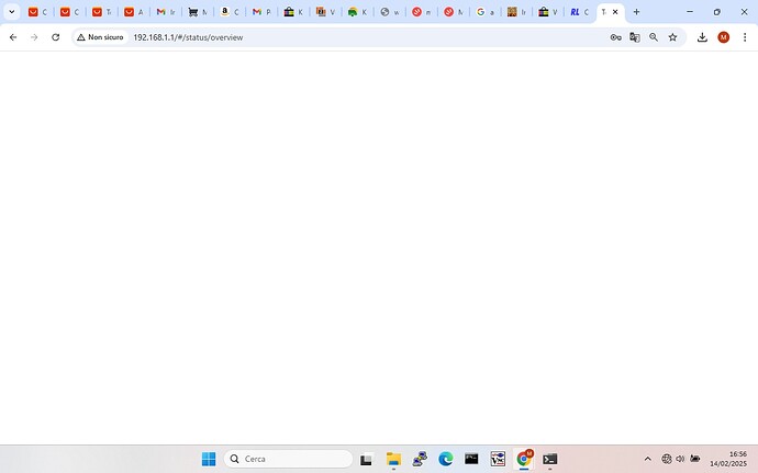

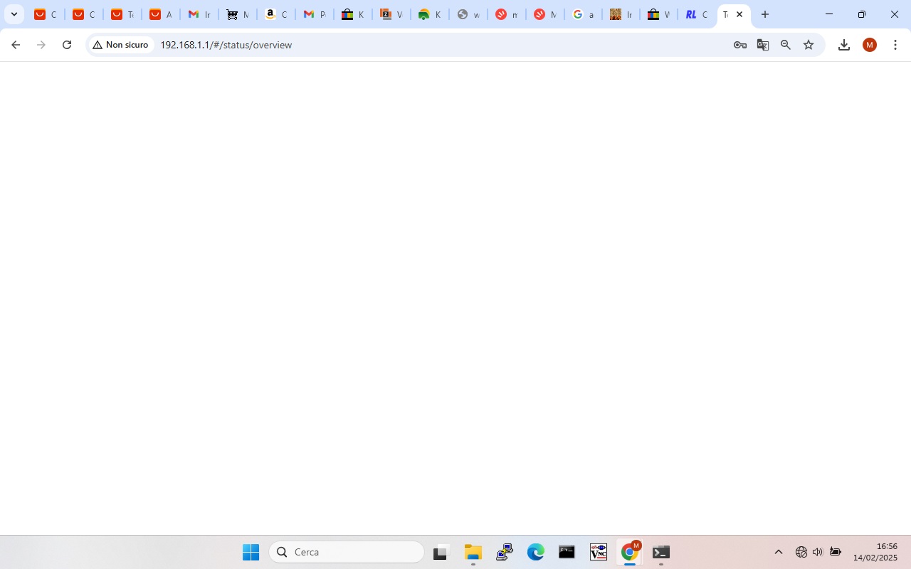

    Blank scteen.
What is wrong?
How can I solve?
