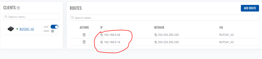

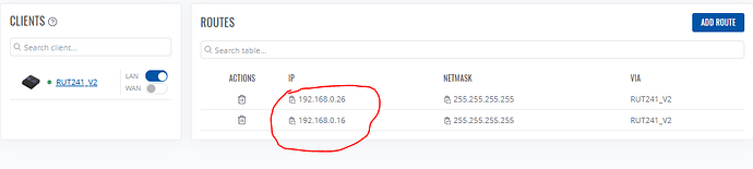

I have a situation that I cannot find a solution to. I have RUT241 (RUT2M_R_00.07.05.4). It is connected to the Internet as a WiFi client. Two devices are connected to the LAN of the RUT port through an unmanaged switch (RUT241 LAN static IP 192.168.0.10, mask 255.255.255.0). The first device is a Siemens LOGO PLC (static IP 192.168.0.16, mask 255.255.255.0, gateway 192.168.0.10) and an ACE sensor panel (static IP 192.168.0.26, mask 255.255.255.0, gateway 192.168.0.10). Both of these devices are pinged through the CLI from RUT241, and all devices (including RUT241) are pinged from a PC connected to the local network. I had the task of creating a VPN connection with these two devices (192.168.0.16 and 192.168.0.26) using RMS VPN hab. I created routes to these two devices (they were both found through the autoscan feature). My problem is that remotely through the VPN I can only access 192.168.0.16 but I can’t access 192.168.0.26 at all (ping command). I don’t understand what the problem is, since both devices are pinged from RUT241 itself. I am attaching some photos

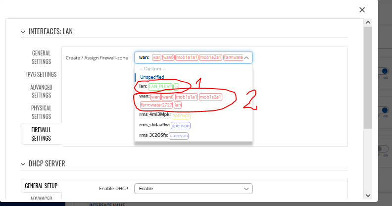

Could you please try enabling masquerading on the LAN => WAN/RMS zone in Network → Firewall → General?

After I changed the Firewall settings (by default I had settings 1) When I put settings 2 everything worked. Of course, I don’t understand why it worked with 192.168.0.16 before and not with 192.168.0.26. The main thing is that it’s ok now.
