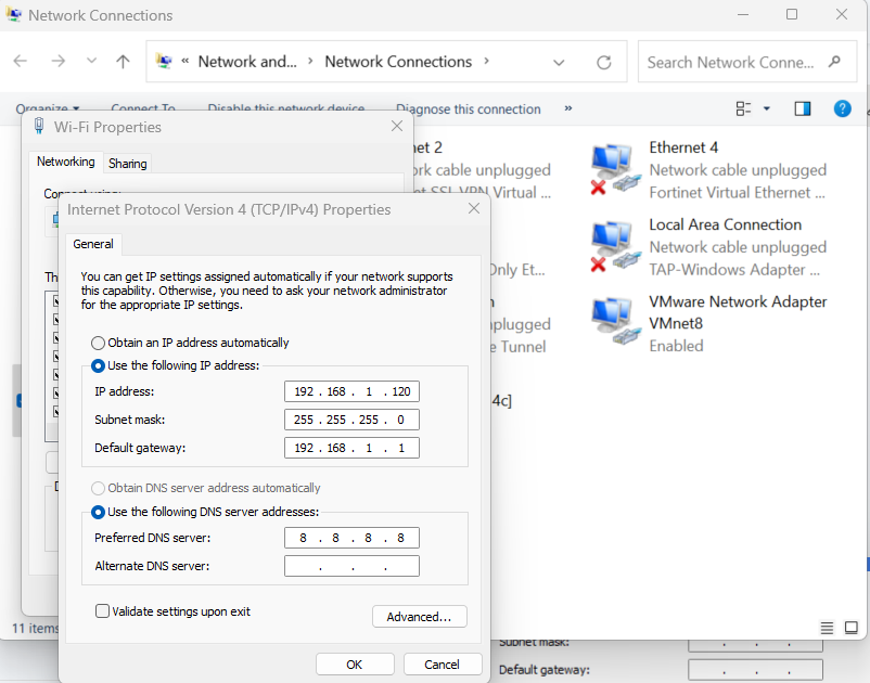

It would have been really helpful if there was a ethernet connection to the RUT as it would fasten up the process, If not what we can try is to Reset the router following this
and try to set a static IP for the Wifi Interface with the device IP here
Please revert to us in case the issue persists
