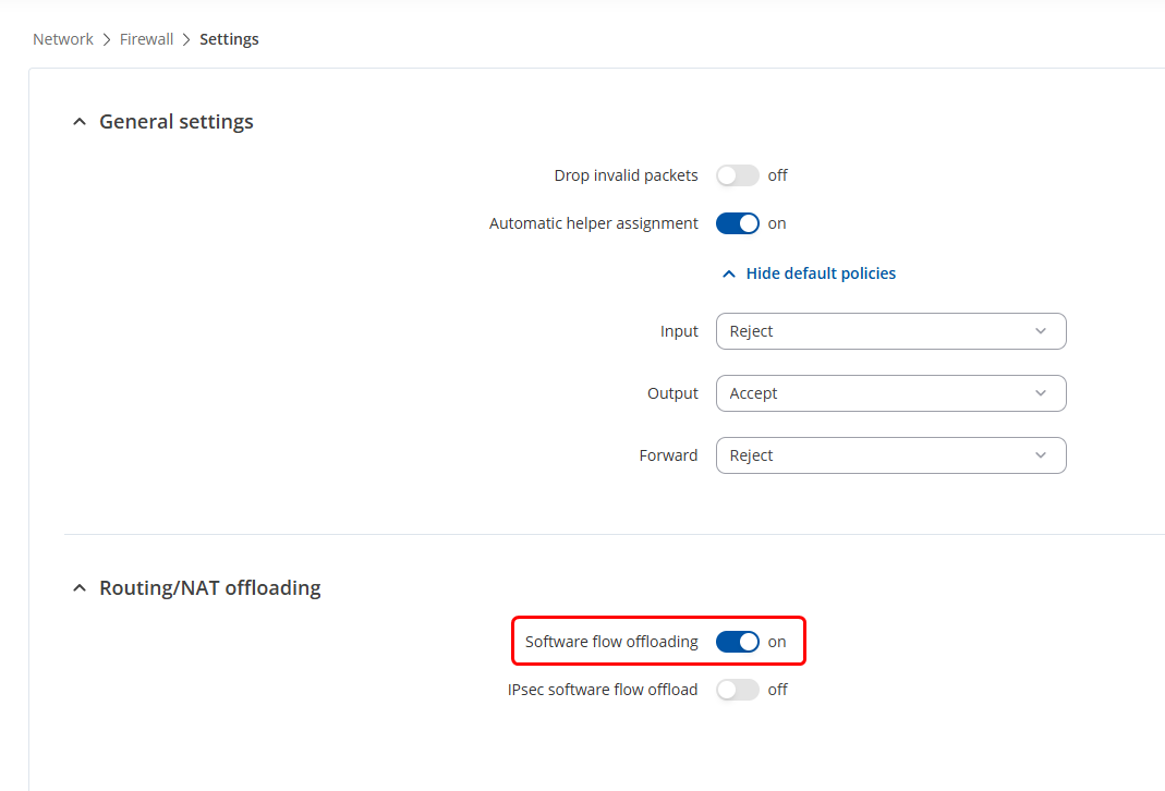

Not that we are aware of, at least. However, you could try disabling Software flow offloading, it might help. The setting can be found under WebUI → Network → Firewall → Settings:
