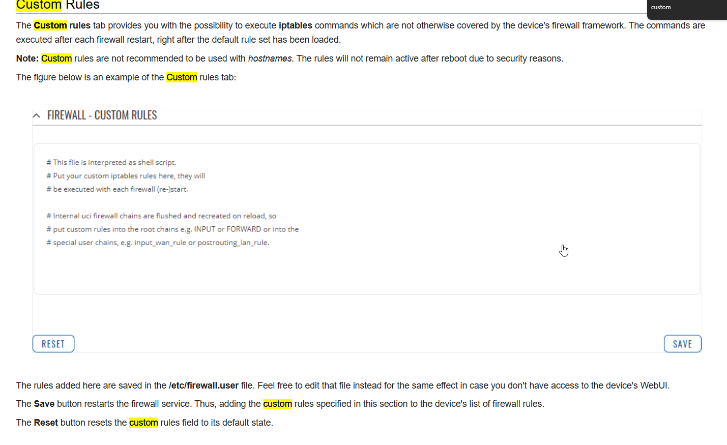

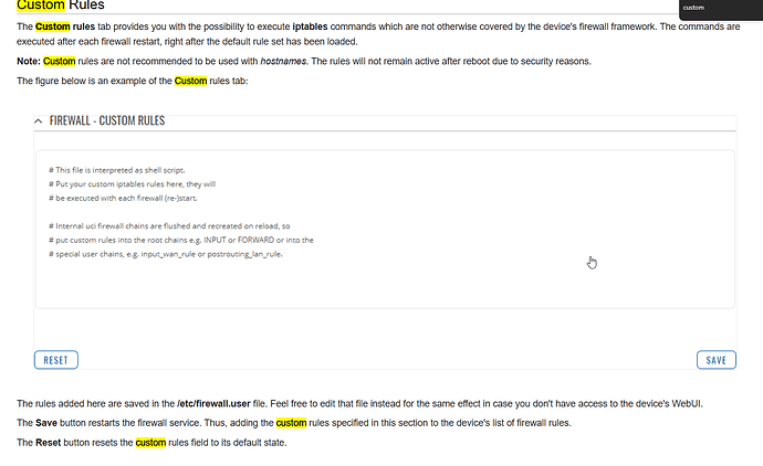

Rutx11 wiki told the custom rules are located in /etc/firewall. user file. In my Rutx11, I cannot find in question file /etc under the directory. Has the file location changed in a firmware version or are the instructions outdated?
Kernel: 6.6.87
Firmware: RUTX_R_00.07.15.4
Look in /etc/config/firewall for regular firewall settings, and the custom iptables rules are in /etc/firewall.user
/etc is a subdirectory of root, and not a file. The instructions are not outdated.
