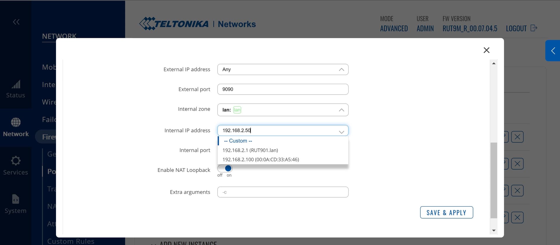

Cannot set and save custom IP on port forwarding on RUT901
After I type the custom IP which is not on the list (192.168.2.50) and press enter and save it does not store/save the typed IP address it reverts to the IP addresses which are already on the list.
when I want to create a port forward to a device then I always have
this device connected to the router.

Make sure you are entering the IP address into the ‘--Custom--’ field in the dropdown menu itself.
Hi, I am and that is the trouble. I choose the custom, type in the IP, but I will not let me store it.
I am unable to replicate this. Are you sure that you are typing the IP address in the dropdown menu as highlighted in my screenshot (192.168.10.2 being entered)?
You can try using a different Web browser and/or clearing Web browser’s cache.
